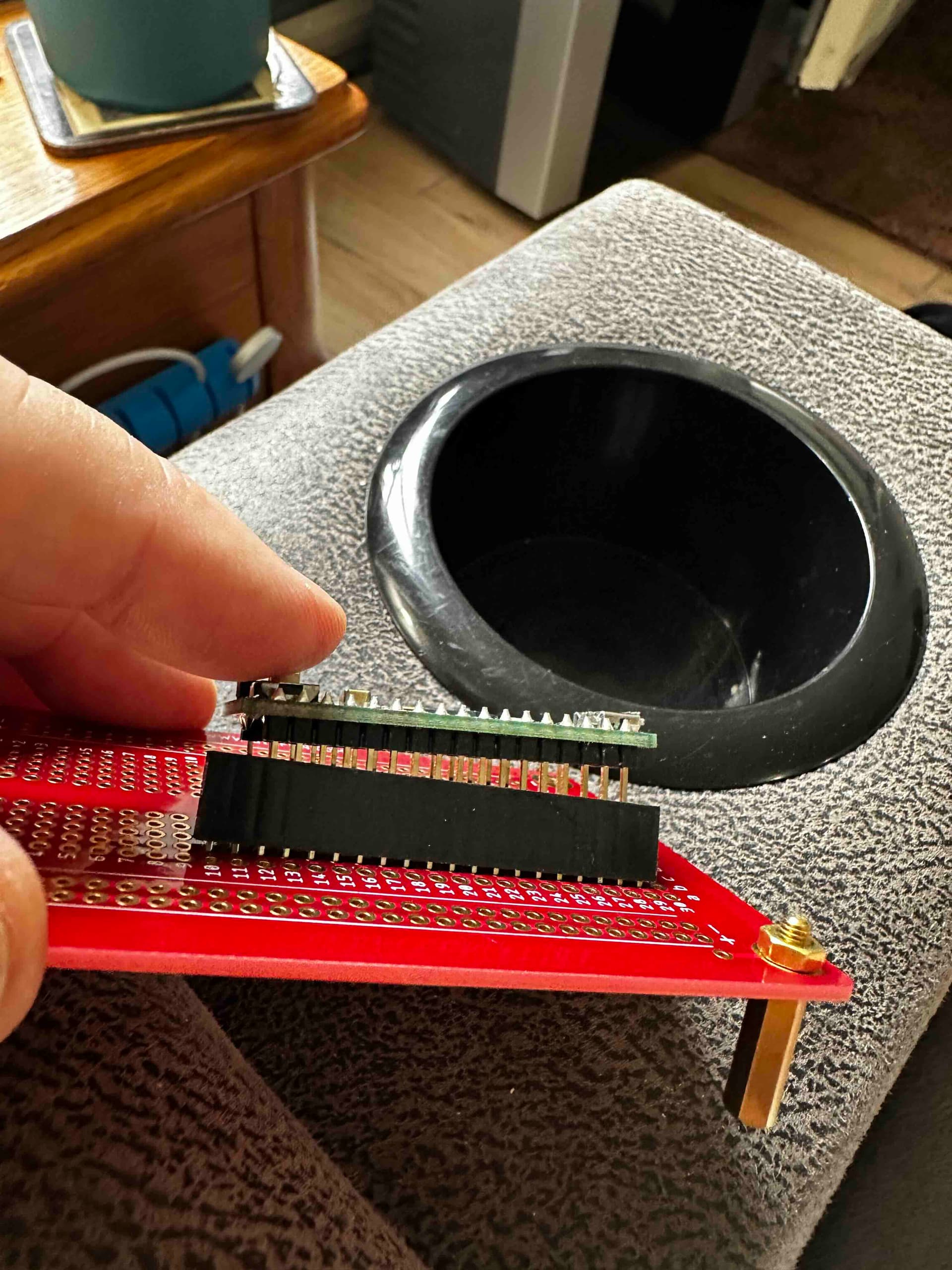

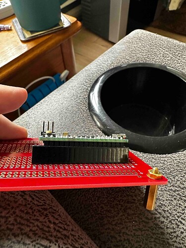

A3, A4, and A5 do not read the pentiometer when I press the male connecter to the sides of the hole. Is this something that needs to be soldered to test?
Did you change the pin number in the analogRead() call in the code?
Yes.
You have to solder them.
I'll do that. Thank you.

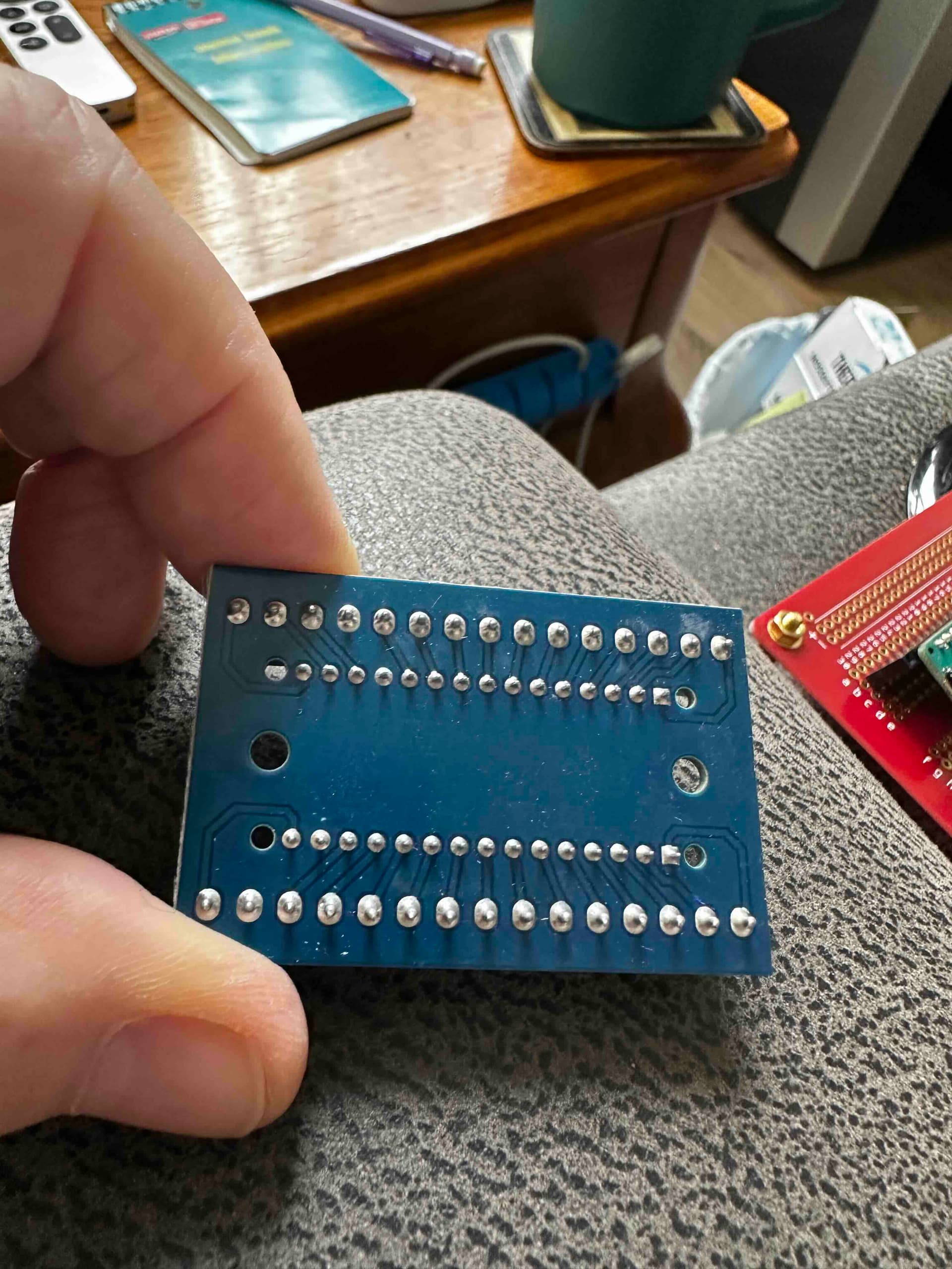

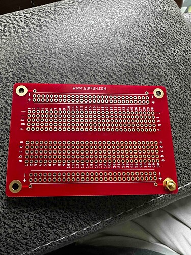

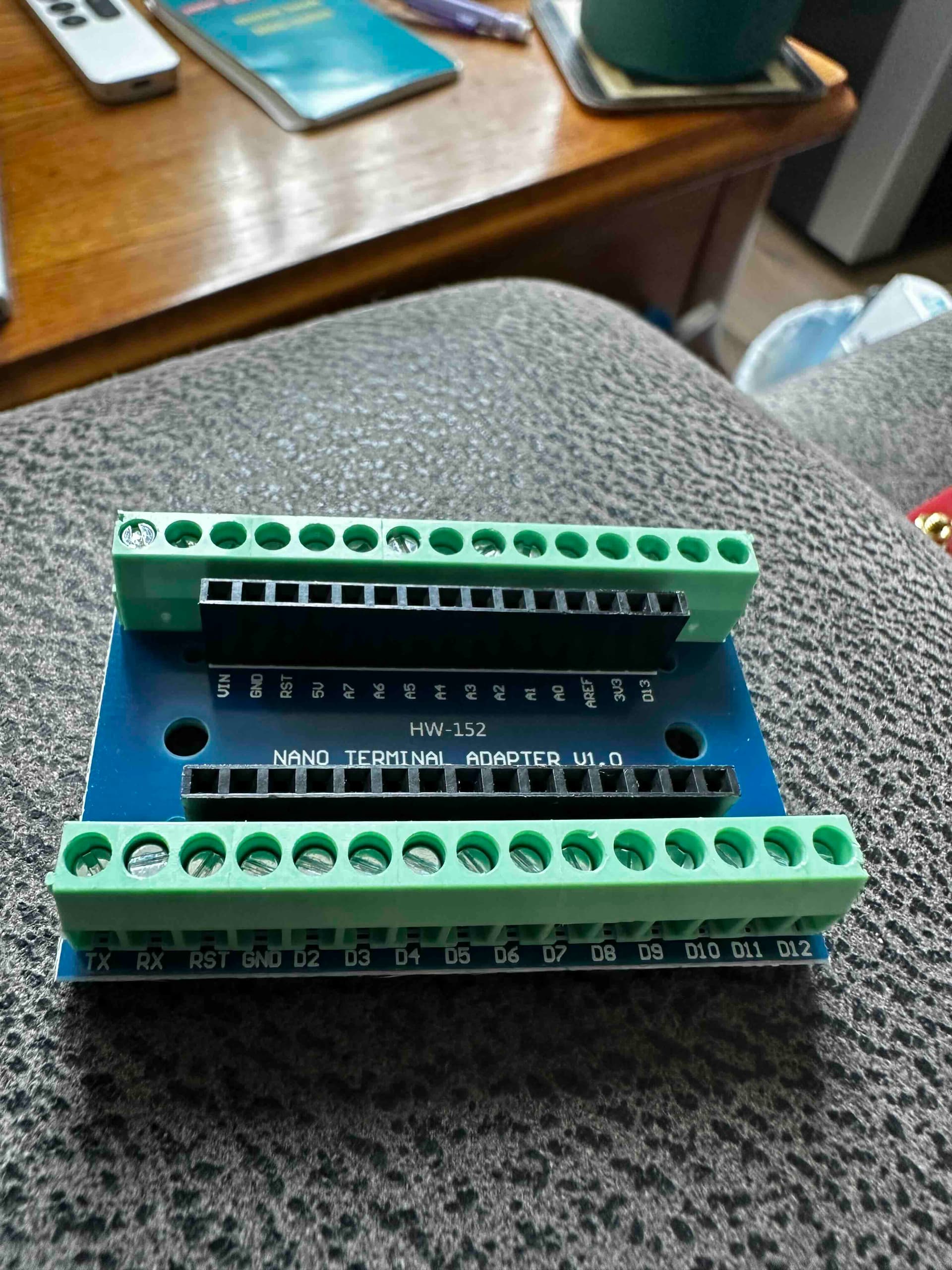

Here are some ways (there are more most cheaper) to mount an Arduino.
The first one is an off the shelf type. Just plug in the board, then insert bare wires into the screw connectors. NOTE protect the back from shorting, I work on a rubber pad.

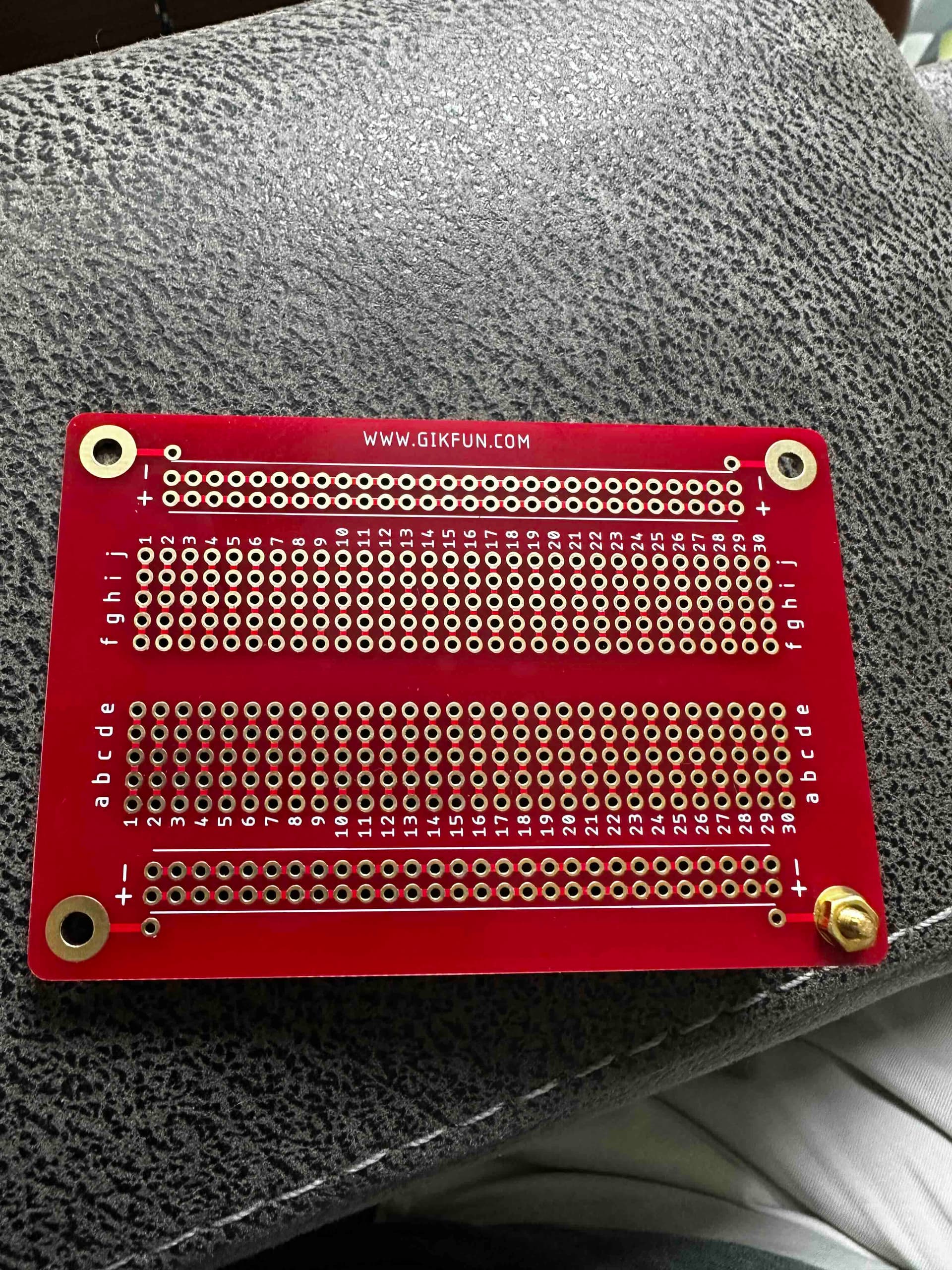

Here is breadboard type proto board. I attached a brass stand off you can get plastic and both in different lengths. To make connections from the board to something you can double the female hdrs and plug in dupont wires, or if permanent solder in the bare wire. This board the holes are not connected, I have others that are just like a breadboard. Lot's of solutions. The worst possible is soldering directly to the Arduino.
That is a lifesaver. So much easier than soldering each pin individually.
This one is a little harder, still a lot better.

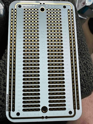

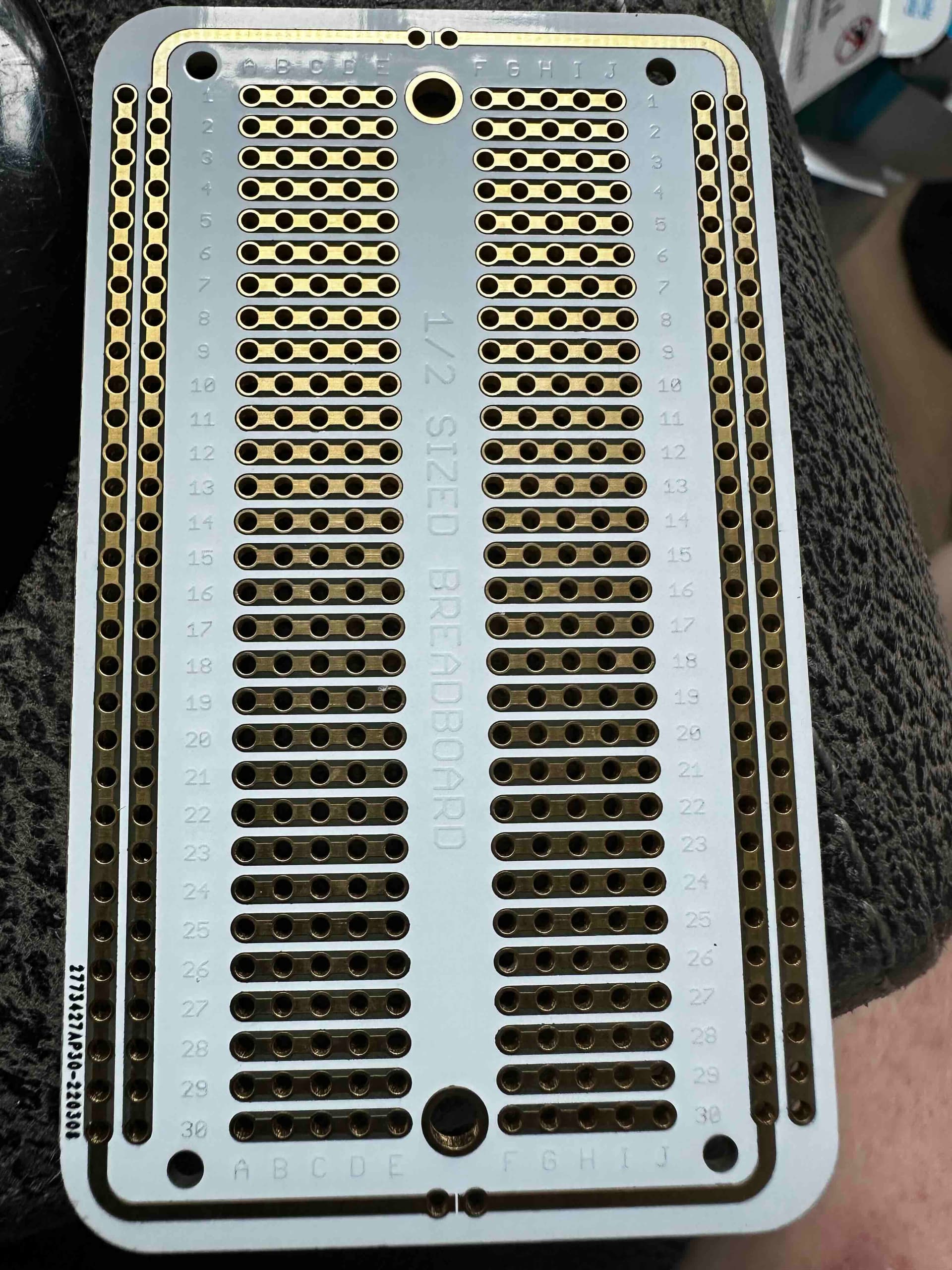

This one is a solderable breadboard, the holes are connected together the same way.
That one is a little big but it'd still work.
