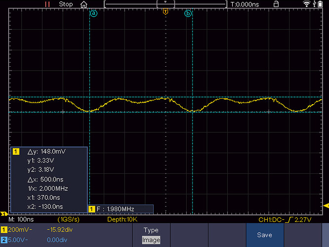

OK, here are my test results.
I get values from 993 to 1023. Attached you can find a screenshot from my oscilloscope. You can see the following.
There is a voltage ripple from 3.18V to 3.3V with a frequency of 2MHz (this is the switching frequency of the MPM3610).
When you compute the values seen by the A/D.
3.3V / 1024 * 993 is 3.20V.
The A/D converter is seeing exactly what the oscilloscope is seeing.
Thanks Klaus_K! Your feedback makes sense. But the ripple voltage measured with the oscilloscope is crazy. I’m wondering how to solve this problem.

The nRF52840 does not have a separate ADC reference pin. The ARef pin does not have a connection in the schematic and therefore the pin is likely NC.

In order to get a better 3.3V line, you should desolder R9 (39K resistor from AAM pin of the mpm3610 to ground). That will make the mpm3610 works in ccm mode always, which is the low noise mode.

Yes, it’s a real bummer. Arduino should have made this a 5V maximum input voltage product. The MPM3610 works over a large input voltage range and provides quite a lot of power, but the noise in this implementation is bad. It would be interesting to see whether a better layout could solve this issue.
