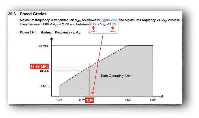

I'm a bit confused in what you do.
what's the clock speed on your board? (you power it with 3.3v right?)
the spec for a 328/P states
Speed Grade:
̶ 0-4MHz@1.8-5.5V, 0-10MHz@2.7-5.5.V, 0-20MHz@4.5-5.5V
and you have a table that shows
so @3.3V you can't run @16Mhz without expecting flaws.
the spec also states
1.1.7 AVCC
AVCC is the supply voltage pin for the A/D converter, PC3:0, and ADC7:6. It should be externally connected to VCC, even if the ADC is not used. If the ADC is used, it should be connected to VCC through a low-pass filter. Note that PC6..4 use digital supply voltage, VCC.

Hi JML
Yes powered by 3.3v out of the boost converter. Running at 8mhz via a external crystal.
Thanks
Kevin
