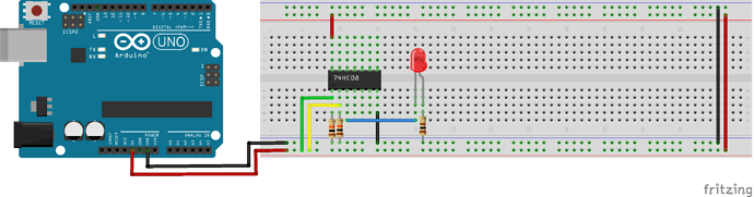

I have a SN74HC08N IC and i've been trying to get it to work properly but i can't get it to work properly.
The pulldown resistors are there, each on one input. When i connect input A to positive it gives a positive output, even if the B input has nothing but the pull down resistor. When i connect only the B input, it gives a negative output. What am i doing wrong?
The truth table that i'm getting:

Do you have meter to check the voltage with just the pull-down resistor? The datasheet says it should be less than 1.35V to guarantee a logic-low.)
It's probably because you're trying to drive an LED at around 24 to 30mA, from an output that can only drive up to 4mA! Change that 100Ω resistor to around 620Ω or even 1k (hard to say, for sure, 'cuz I don't know what kind of LED you are playing with, but, if it's one that came with an Arduino "kit", then it's probably the dim kind). Also, if that LED is the dim kind, and not of the Super Bright class, it may, at that low a current, be too dim to see. Maybe drive the LED with a transistor (Google it).

I would go with the “pull down resistor on A has a bad connection” theory.
Also drop the pull down resistors to 470R or there abouts.

Besides that, i got it to work like this: instead of leaving the inputs connected only to the pull downs, i connected the inputs directly to ground in addition to the pull downs. That got rid of the weird behavior, and produces the correct truth table.

I measured the current between the input and the resistor and it was slightly above 1.5v. I replaced the resistor for a 1k resistor and everything works well now. I thought that a higher resistor would limit the current much more than a lower resistor, but i probably didn't take into consideration the "direction" of the current. Thankfully it's been solved.

Yes it does. What you are trying to do with that sort of logic is to suck current out of the input to get a logic low. With the higher resistance you were not sucking enough current to make the input voltage drop below the threshold for a logic zero.

But, let me say this: The datasheet, for the SN74HC08N states a worst case current demand on any one if this IC's inputs, as 1µA. At that level of input current, the difference between 10k and 1k is miniscule. It should work just fine with a 10k pulldown resistor [you're sure it's an SN74HC08N, and not, perhaps an SN74H08N?]. Which brings me back to that 100Ω resistor in series with the LED on the output. If this truly is a SN74HC08N, then 100Ω really is too low. It should be more like 680Ω to 1k.
The fact that it's "working" is probably a fluke. In fact, come to think of it...if you are shorting across the resistor to achieve a "low" on an input of the SN74HC08N, then you are shorting out the Arduino supply, so, of course the LED goes out, thus mimicking an AND behavior. There are no sparks, or smoke, as one might expect from a short, because the Arduino's voltage regulator has output short-circuit protection.
The proper way to do it is to remove the wire, that is connected to +5V, when you want an input to be low. When the wire is connected, that is a high. When you remove the +5V wire, the resistor pulls the input low [thus the moniker "pulldown"] .
On further thought, because that 100Ω + LED, on the output exceeds the specified ABSOLUTE MAXIMUM current on an output, odd things may be happening -- like a greater current demand on the input, thus giving the impression that a 1k works better than a 10k.

OK, guys...let me esplain... First of all, what I meant by removing 5V wire for low is this: if you look at jorgeguberte's diagram, you'll see that he has, on each input, a wire going from the input, to +5. ALSO, there's a 10k resistor going from the input, to ground. SO, if you remove the wire going to +5, the 10k resistor is still there, pulling the CMOS input low. Thus, removing a +5V wire, in this case, is a way to cause a LOW condition.
And, in a later post, jorgeguberte states that he "instead of leaving the inputs connected only to the pull downs, i connected the inputs directly to ground in addition to the pull downs." he/she doesn't say anything about removing the wire that goes to the +5 line -- so, I was thinking that maybe jorgeguberte was doing his direct to ground hook-up, WITH THE +5 WIRE STILL IN PLACE. That would, of course, cause a short to ground. And since the +5V line is being supplied by the Arduino, this short would put the Arduino's regulator in short-circuit-shutdown. And, episofacto, that would behave JUST LIKE AN AND FUNCTION -- thus giving jorgeguberte a false positive.
