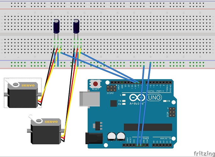

I am new to to the forum and working with arduino. I was hoping I can get some help on an issue that I am trying to figure out. I built an animatronic for my classroom using an arduino uno and two radio shack micro servos (Catalog #: 2730765). The original code works fine.

I checked the board and it does have a continuous line. I also tested the two suggestions you gave me. Neither one fixed the board. While I was working on it, I did learn one thing. The tail servo can work on it's own the mouth servo does not work on it's own, but if the tail servo and mouth servo are moved at the same time, it will work. This code does work as intended.
mouthServo.write(80);
tailServo.write(80);
mouthServo.write(40);
tailServo.write(100);
If I take out the tail segment tailServo it will no longer work and you will here the servo struggle to move. What would cause that too happen?
Have you tried swapping the servos?
Only having one servo plugged in when you test each servo?
Have you tried a separate power supply for the servos?
It sounds strange that two will work together, but one on its own will not.
Can you post a picture of your project so we can see your layout?
Thanks.. Tom.. :slight_smile:
Thanks for the suggestion. When I swapped the servos it was the servo that wasn't working right. Now I know I can get it replaced.
Check your power supply is adequate and that neither servo is blocked from moving
by the mechanism - a stalled servo will heat up and cook itself quite quickly. Even small
servos need 1A or so each typically, and its a hugely common mistake to underprovide
the power for them.
MarkT:
the power for them.
I was about to suggest the same, a separate supply for the servos.. My general rule of thumb, 2 or more servos, NEVER power them from the on-board +5V regulator, ALWAYS add a 2ndary +5V circuit, a LM7805 regulator between the main supply (wired in parallel with the +9V power supply before the barrel socket, NEVER from the Vin pin) & the Arduino, to a supply rail for the servos...
