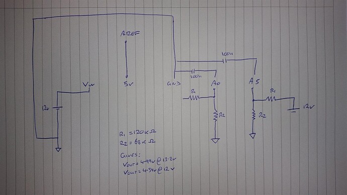

So, I thought I'd start with the basics and measure the voltage. Having understood that I can't have more then 5vDC going into the Uno, I built a simple voltage divider, but I am getting weird results and I don't know why...
I've attached my Fritzing diagram of my divider - a 1M resistor, a 100K and a lead going to A2 on the Uno.
I've used the sketch from Measuring Voltage with Arduino - exactly as is, but updated after measuring my voltage
The Uno is connected via USB only and the 12v input is from a spare transformer I have. This is connected to a variable DC voltage selector, so I could select 12/9/6/5/3 volts and mimic drain on the battery pack.

Connect the grounds!!
Those resistor values are awful high, especially with no cap on it to stabilize it. I'd try for lower total resistance and a cap on it to stabilize it. Then go from there.
Oh, and we hate fritzing here. Hand drawn is preferable.
As DrAzzy said. Connect the grounds.
Resistor values are not a problem... if a 100n cap from analogue pin to Arduino ground is added.
Resistor ratio of 1:10 is a bit odd.
Are you measuring a 12volt battery?
A/D is not fully used with 12volt input and default Aref. And 1:10 will give overflow with 1.1volt Aref.
Leo..

Thank you all so much - as you might expect from a noobie, I now have more questions!!!
Connect the grounds - do you mean I need to connect the ground of the supply to the GND of the Arduino?
I chose the ratio of 1:10 because that seemed to be what the examples I came across were showing - but thinking about it, a factor of 3 would be sufficient?
As I understand it, the higher resistor values would draw less load from the battery source - but I guess the draw is so low anyway it doesn't really matter...?

OK, so I think I have this figured out and working now for both Circuit A and B - I have attached a new diagram...
I also modified the sketch to read the 2nd voltage on A5 - and this is working too!
I think the calibration values need a tweak as the voltages that Arduino is reporting are a bit different to my DMM, but actually, for my needs, this is probably not a huge issue...
When the A2 has no load on it, I still see a voltage reading. I'm guessing this is because of the Arduino itself, so I simply subtracted the reference voltage value from the calculation - but not sure this is the right thing to do??
I still have not added the cap to the circuit, as I don't have any to hand...
@Wawa - you said a 100n would be what I needed - how do you calculate this, please?

AstroDaz:
The A/D needs a 'solid' voltage on the analogue pin to take a sample from.
Something with a <10k impedance is in the chip's datasheet. You have used 1Megohm.
The internal A/D cap could have some charge left from a previous measurement of another analogue pin.
The (tiny) sample capacitor inside the chip, with a >10k divider, hasn't got time to fully equalize with the voltage of the divider. The first sample(s) will be bad.
A common fix is to discard the first sample.
A 100n cap on the analogue pin acts as a miniature battery.
When the A/D comes along to take a sample, it sees a solid voltage to sample from.
Still don't understand the 1:10 divider ratio you use.
With default Aref, you throw away accuracy.
Better to use ~1:13, and 1.1volt Arref.
Stable and smaller voltage steps.
Leo..

OK, I think I understand more now - at least I hope so!!
I found tutorials on the AREF and went through those, and have modified my sketch and circuit accordingly.
So, now, I feed the AREF from the Arduino 5v and use the following sketch (taken from tronixstuff - Arduino Tutorials – Chapter 22 – the AREF pin | tronixstuff.com):

My circuit now looks like the attached.
I also hope I've understood about the resistor values. I chose 120K and 68K as they give no more than 5v on the analog lines - regardless if it's a 12v supply (battery) or 13.8v (regulated bench supply)
I've added the caps to the circuit, and all the grounds tie back to a common point.
Huge thanks to all - especially Leo!
And of course, the R1, for pin A0 should be connected to the 12v supply line!!
It was a deliberate mistake!!
I have built this on the breadboard and seems to work exactly as I need!

AstroDaz:
No...
You won't have to do, connect, or code anything for default 5volt Aref.
Disconnect that link before you smoke the Arduino.
That resistor ratio is ok for default Aref.
EXTERNAL or INTERNAL is if you want to use a DIFFERENT Aref.
http://www.arduino.cc/en/Reference/AnalogReference
Default Aref is the potentially unstable 5volt power supply.
Good enough for most things, but not so good for accurate/stable voltage measurements.
Arduino also has an inbuild very stable 1.1volt Aref.
If you decide to use that, all you have to do is calculate your divider for ~1volt out.
And enable that 1.1volt Aref in the setup.
The maths line to convert A/D value to voltage also has to be changed from 5 to 1.1.
