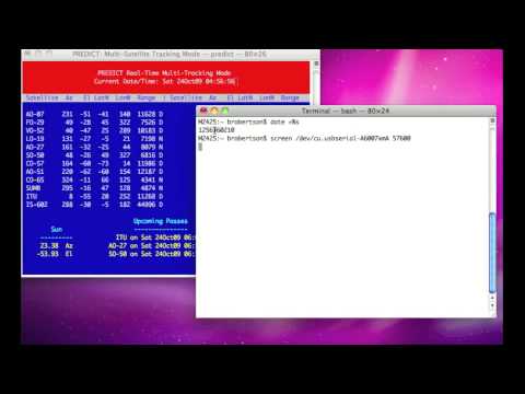

I've written a library that simplifies the use of ansi terminal escape codes. The updated version of the code resides at:
http://code.google.com/p/qrptracker/source/browse/#svn/trunk/Arduino/libraries/Ansiterm
And you'll find a video of a useful application of this library at
The files as of [timestamp=1266006177] are Ansiterm.h
Ansiterm.cpp -- an Arduino library that simplifies using the ANSI terminal
control escape sequences. This allows your code to  position text exactly in the
terminal, to add colour and other effects. To use Ansiterm, an ANSI terminal must
be connected to the Arduino's serial port. The terminal built into the Arduino
IDE does not respond to the ANSI codes, but most MacOs and Linux terminals do.
In Windows, I read that Hyperterm responds to ANSI codes. Realterm responds to most
codes, but will not change the color of the foreground.
The accompanying example file illustrates the library's use.

A test program that puts it through its paces is:
#include <Ansiterm.h>
char * messages[][3] = {{"Name", "Age", "Favorite Sport"}, {"Bruce", "42", "Arduino"}, {"John", "23", "Baseball"}, {"Joel", "9", "Swimming"}, {"Phoebe", "14", "Highland Dancing"}};
Ansiterm ansi;
  Serial.begin(38400);
  splash("Testing 'forward', 'backward', 'up', 'down', and overwriting ...");
  ansi.home();//works
  ansi.eraseScreen();
  ansi.setBackgroundColor(BLUE);//works
  ansi.setForegroundColor(GREEN);//realterm doesn't do this, macos does
  ansi.forward(10);//works
  Serial.write("10");
  ansi.forward(10);
  Serial.write("20");
  ansi.forward(10);
  Serial.write("30");
 ansi.down(1);
  ansi.setBackgroundColor(RED);
  ansi.setForegroundColor(WHITE);
  Serial.print("White on red, to be erased");
  ansi.eraseLine();//works
  ansi.up(1);//works
  ansi.backward(50);
  Serial.print("One line above, this to be written over");
  ansi.backward(20);
  ansi.setForegroundColor(BLACK);
  delay(2000);
  Serial.print("this appears over the last line");
  delay(2000);
  splash("Testing tabs (doesn't seem to work)");
  ansi.setTabAtColumn(33);//doesn't seem to work
  ansi.setTabAtColumn(66);
  Serial.write(9);
  Serial.write("33");
  Serial.write(9);
  Serial.write("66");
  splash("Testing xy function ...");
  ansi.setBackgroundColor(YELLOW);
  ansi.eraseScreen();
  for (int x = 1; x < 60; x+=10) {
    delay(200);
    for (int y = 1; y < 14;  y +=2) {
      ansi.xy(x,y);
      Serial.print(x,DEC);
      Serial.print(",");
      Serial.print(y,DEC);
      delay(200);
  ansi.eraseScreen();
  splash("Making a table ...");
  //ansi.setBackgroundColor(MAGENTA);
  //ansi.setForegroundColor(YELLOW);
  for (int x = 0; x < 3; x++) {
    for (int y = 0; y < 4; y++) {
      ansi.xy(x*20,y+1);
    if (y == 0) {
    else {ansi.setForegroundColor(WHITE);
    Serial.print(messages[y][x]);
  delay(4000);
  ansi.eraseScreen();
void splash(char * message) {
    ansi.setBackgroundColor(BLACK);
   ansi.eraseScreen();//works
  ansi.home();
  ansi.setBackgroundColor(GREEN);
  Serial.print(message);
   ansi.eraseScreen();
