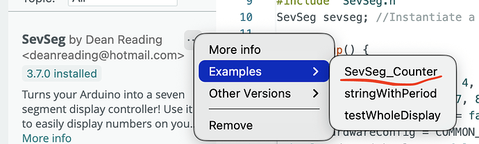

Have you tried the example sket ch in the library called SevSeg_Counter. It does
This example demonstrates a very simple use of the SevSeg library with a 4
digit display. It displays a counter that counts up, showing deci-seconds.

Yes, I posted a little bit of that code in post #3. That is actually a snippet of that exact code you mentioned. I am just going to try to wrap my head around that and, and then reformat the code to work as a switch, instead of just counting. That was why I mentioned that code snippet.
