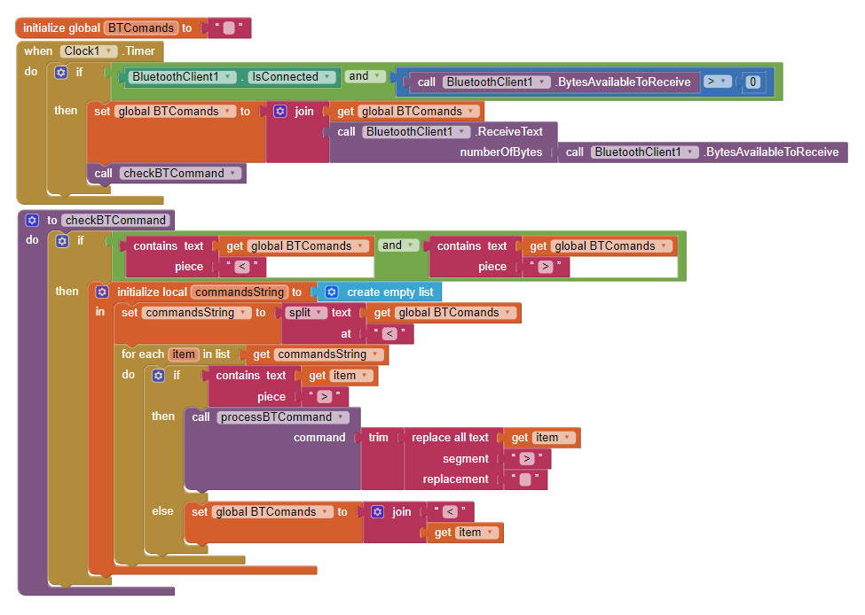

In App Inventor, how do I make sure that the whole part of string is received?
I'm continously sending text commands between arduino and an android app. I use a function on arduino, which makes sure that the whole command arrived before processing it further:
(Credit: @Robin2)

Now, how to replicate similar functionality in App Inventor, to make sure that the Clock timer will not split my text commands into parts?
App Inventor (clock at 100ms):
Example:
Arduino (this part fires often):
    my_function(){
      Serial.print(NUMBER);
      Serial.print(":");
      Serial.print(ANOTHER_NUMBER);
      Serial.print(":");
      Serial.println(YET_ANOTHER_NUMBER);
And the test output in my android app:
    • 1:3:150
    • 1:3:150
    • 1:3:150
    • 1:3:1
    • 50
    • 1:3:150
As you can see, the 4'th command has been split into parts. How do I prevent this?

I got it however working using a bit simplier design :slight_smile: There're holes but it's good enough for my needs

you would use a character delimiter to signify the beginning of a packet and the end of a packet (string/data..etc)
I have only used App Inventor to create apps to SEND BT (serial) data to an Arduino... never from Arduino to BT device yet. (but the same theory applies on the Arduino side of things.. knowing when to start and stop collecting data for your 'packet'..

@xl97 would you be so kind as to post a picture of your blocks for your app inventor project on the matter you stated?
I am trying to achieve the same outcome as philip, in my instance receiving text from an SD card instead.
I have made an app that sets the received_data to BytesAvailableToRecieve but all I get is a bunch of "-8 -128 -8 -128" etc........
