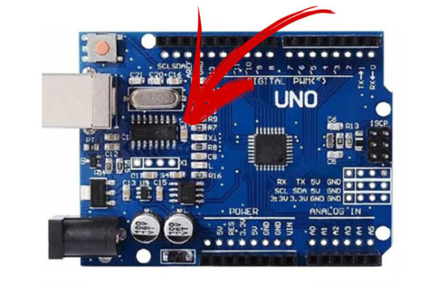

It will be useful for us to know which USB to serial adapter chip your Arduino board has. This is a black chip near the USB socket.
The chip will usually be identified by writing on the top. This might say something like "Atmel MEGA16U2" or "WCH CH340G" or "SILABS CP2102" or "FTDI FT232RL".

If it isn't clear, alternatively you can provide the link to where you bought the board from and we'll see if we can determine the chip from the product listing.
IIRC there are older reports about the CH340 chip on Apples.
My knowledge on apples is also limited.
Maybe a forum search will turn up some results for you.
