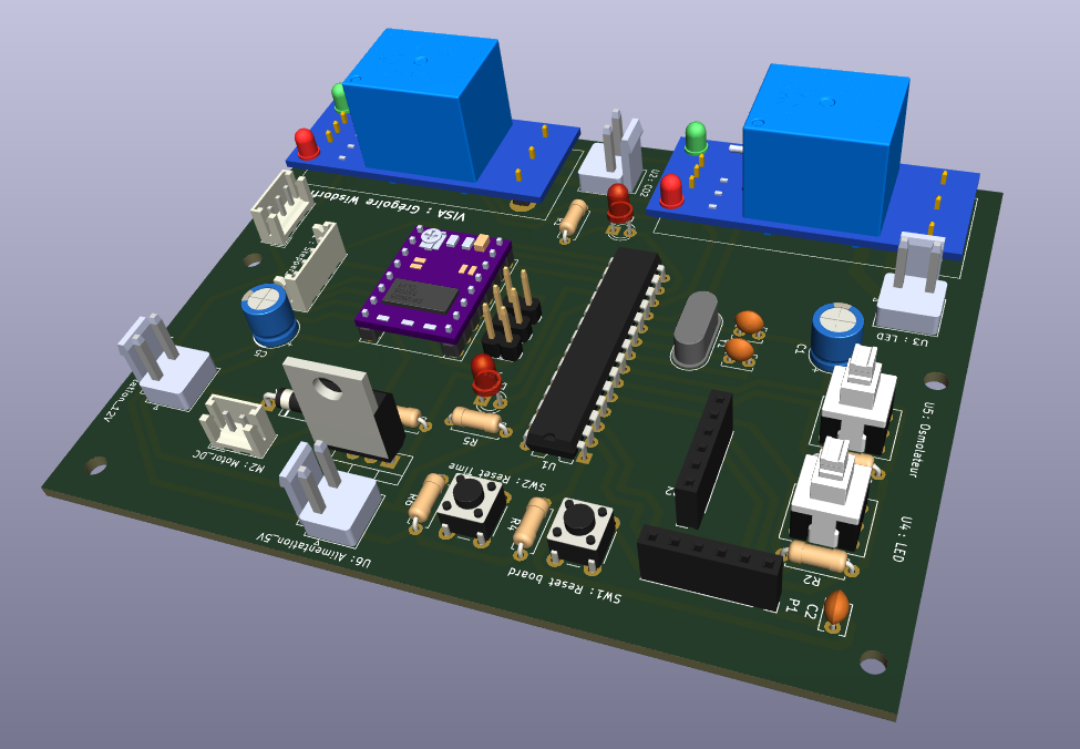

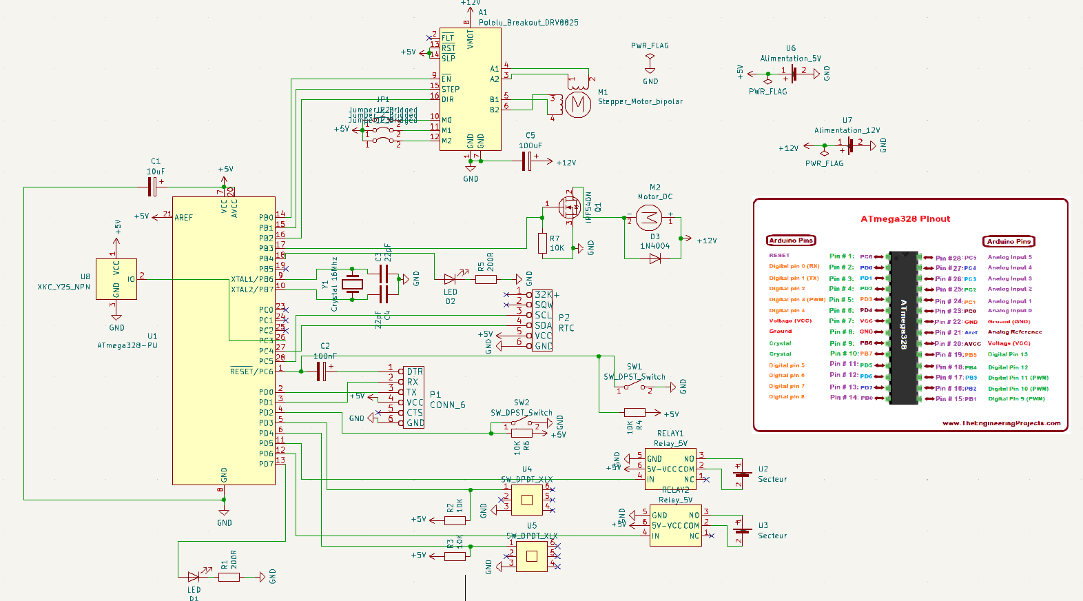

To do this, I've designed a PCB that controls all of this using an ATMEGA328P setup, an RTC module for time, and an FTDI for uploading the program. There are also 2 LEDs for debugging and the following buttons:
  • A button to reset the board
  • A button to update the time of the RTC module
  • A button to manually turn on the light and CO2 at the same time
    -A button to start the aquarium filling, which stops automatically
Unfortunately, I don't understand why, but the program freezes sometimes... So the light doesn't turn on, which is not good at all for my fish and plants if I go on vacation. In fact, I just left for 3 days, it bugged and I lost a fish... I feel like the problem occurs between turning on the CO2 and the LED, and it might be due to the RTC module, but I'm really not sure. I specify that the control and power circuits have two different power supplies. Does anyone have an idea of the origin of my problem?
Below is my program along with images of the electrical circuit. Feel free to ask if you have any questions or comments on my post, this is the first time I've done this! Thank you in advance!

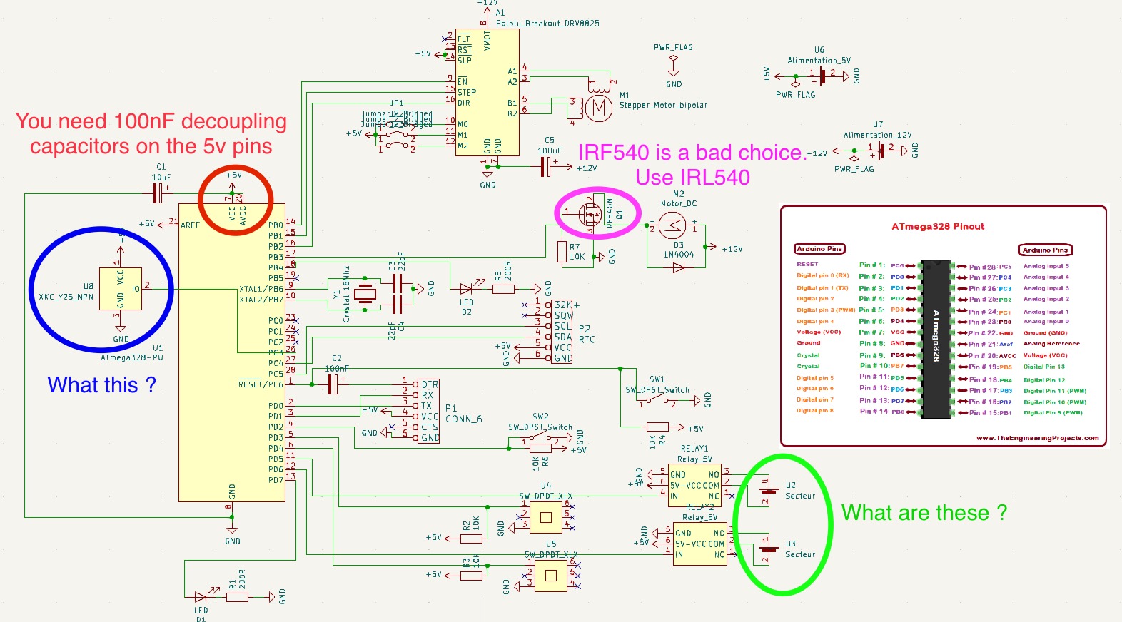

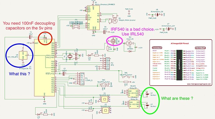

  • Let’s start here.
    What do you think is happening with this ?
  Serial.println("test");
  if (digitalRead(pinBout3)==0){
    rtc.adjust(DateTime(F(__DATE__), F(__TIME__)));  //  <——<<<<<
  • How are you powering the 328 controller ?
  • What does this do ?
    stepper.setSpeed(-2000);
Hello LarryD!
First of all, thank you LarryD for your promptness! I'll address your questions:
  • To me, the line "rtc.adjust(DateTime(F(DATE), F(TIME)));" updates the time stored in the RTC module with that of the computer (used only when computer is connected). But in reality, I never actually touch that button because the RTC module drifts very little.
  • The "XKC_Y25_NPN" module is a non-contact liquid sensor that I attach to the outside glass of my aquarium to know when to stop filling it. Here's the module: [link]
  • The IRL module is more appropriate because it requires 5V at the "Gate," unlike the IRF which requires 10V, is that correct?
  • U2/Sector and U3/Sector are the 220V power supply for my LED and my CO2.
  • Isn't my 10uF capacitor a decoupling capacitor? Should I replace it with a 100nF one or add a second one?
  • The 328P is powered by a 5V / 2A source.
  • The line "stepper.setSpeed(-2000);" allows all the fertilizer in the tube to be drawn into the fertilizer reservoir to return to a reference position.
Googling a bit suggests it has an open-collector output. This implies its output should be pulled up to e.g. 5V. You need e.g. 10k between PC3 on your microcontroller and +5V. You have R2 through R5 which you can use as spares since they're redundant. Just make those pins "INPUT_PULLUP" to achieve the same. The resistors there don't hurt. The one across the sensor is necessary, however.
An attempt at a snubber circuit, perhaps? I don't see these electrolytic caps on the PCB, is that right? Any chance we can have a look at the PCB layout. The 3D render of the board looks nice, but doesn't say much.

But to the compiler, __DATE__ and __TIME__ are constants that are baked into the code at compile time.
Yes, more or less correct.
Add 100nF at every Vcc pin of your 328P. I usually include one at AVcc as well.
    This is the time and day when the sketch was compiled. Not a good thing to do here.
    We see no link
    Correct
    Let’s see links
    10uF is okay, add the 100nF ceramic capacitors near the pins too.
    Confirm this voltage with a voltmeter while the unit is running.
    This needs “type” positive long
  • Give us links to Relay1 and 2.
  • Show us good images of the actual wiring.

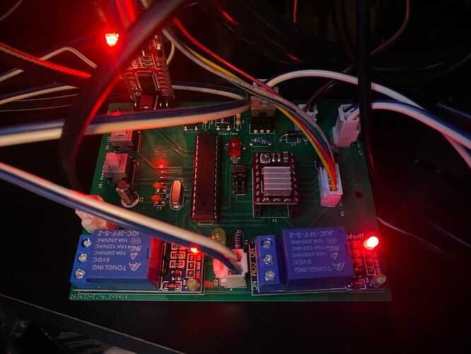

Below is a photo of the setup (the Xkc-Y25-Npn and the RTC are connected below).
  • Kind of looks like EMI is causing this.
    Suggest you try to reproduce this by testing before coming to any conclusion.
  • Do you know what a State Machine is ?
  • AC and power cabling must be kept away from signal wiring, neaten your wiring to keep them away from the PCB too.
  • And suggest the OP never use while( . . . ), a State Machine conversion is highly recommended.

Regarding U2 and U3, it's just a JST connection from which I take one of the terminals of the 220V, so the symbol is incorrect. Sorry for the misunderstanding.
Otherwise, I'm at 4.90V at the 5V terminals.
For the line "stepper.setSpeed(-2000);", it works very well so I don't think it's a problem...
The link for the relays: https://www.amazon.fr/gp/product/B07VS7C7YC/ref=ppx_yo_dt_b_asin_title_o09_s00?ie=UTF8&psc=1
"The 5V pin on P1 might back feed 5v to the PC when the FTDI is connected.": We agree that it's not a problem if I disconnect my 5V power supply when I upload a program with the FTDI, right?
  • Positive numbers only.
  • Or, cut that 5V pin off the FTDI or remove your PCB female 5V pin
I confess I haven't looked into the issue of EMI yet, I'll keep that in mind to test soon. I'm not familiar with what a "State Machine" is unfortunately, but I'll also look into that! However, I've already coded an Arduino program asynchronously with timers and events (but it's been a while). I know it allows you to avoid "delay" statements which aren't clean in Arduino programming, but my program is still quite simple so I didn't think I'd need that kind of thing.
"stepper.setSpeed(-2000);" : Of course, you're right, sorry about that. I'll change that.
I'll make some modifications tomorrow and get back to you!
Thanks again!

  • Every 5v pin on the controller needs its own 100nF decoupling ceramic capacitor; as close to the pin as possible.
  • The IRF540 still needs to be an IRL540.
  • The 5v pins on the relays should have a 100uF going to GND (reservoir capacitor) i.e. next to the 5v pin.
  • The relay modules could be 90° i.e. over the PCB.
  • Suggest you add a jumper on the FTDI 5v pin.
    Pulling the jumper disables 5v connection from the FTDI.
  • SW1 and SW2 are labeled DPST.
Hi and thanks again for your response! Here are the latest things I've done:
  • I added two 100nF capacitors so that there's one on the Aref, one on the AVCC, and one on the VCC.
  • I added two capacitors on the relays.
  • I replaced the IRF540N to IRL540N.
  • I changed the names of the buttons to make it cleaner.
  • I removed the FTDI jumper.
I hope we're good to go this time, just need to test it out!
  • Was suggesting Vcc on the FTDI header connect to +5v through a jumper option.
    That way you can easily isolate PCB 5v from PC 5v.
