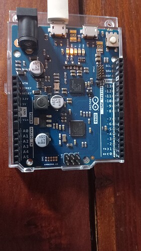

Hi. I recently published a new calculator project for Arduino arithmetic and decimal computing like humans do and it needs being improved for AI. Thanks for all advices and contributions. Sincerly giocip.

suggest you post code as uploadable text instead of screen shots that are too small and hard to read
What do you mean by "arbitrary precision"? For example, what controls the number of digits in the result of calculating 1/7?
By using n7 Arbitrary Precision Decimal Calculator if you input division command:
n7 : 1.0 7.0
result => 0.1428571428571428571428571428571428571428 (40 floating point digits by default)
but this other division command:
n7 div 1.0 7.0 1000
result => 0.142857142857142857142857142857142857142857142857142 ...1428571428
with 1k floating point digits.
You could specify till 2^32-1 (more than 2 billion of floating point digits) limited only
by your own Arduino static RAM and time requested by division C++ algorithm.
