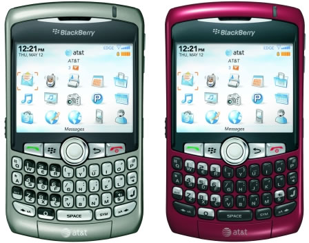

janost:
But you're right about it being cool.
Wish I could find a keyboard that matches the size :slight_smile:
I'm thinking an old cellphone slide keyboard, or maybe a Blackberry...
One of the "for parts" eBay things...

mrburnette:
janost:
I have the top one in my museum :slight_smile:
