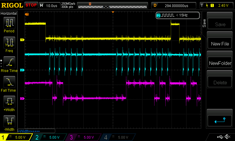

Attached is a screenshot from my scope. It seems obvious that the LCDCL interrupts are lagging behind and would result in incorrect readings of the data.

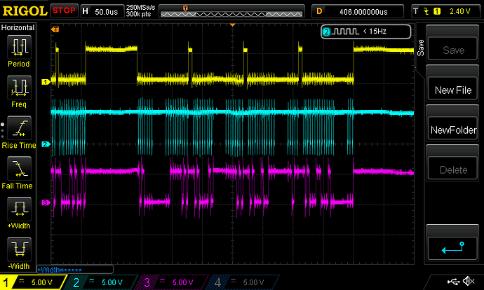

I’m not home till later tonight so I only have a picture of the data being cleaned up by a Schmidt trigger which inverts all the signals but you can see the format of the incoming data. I’ll post a picture of the actual data later.
I agree that the 104 bits can be broken into 13 x 8 bit chunks but I have no control over the sent data format and more importantly the LCDCS or slave selct line which will flush the partially received bits in the incoming SPI register when it goes HIGH.
As requested, here is the 7 frames of data as received. I only care about frames 4 thru 7.
If I read the scope output correctly, the clock signals spikes actually aren't 4µs apart but about 2.5-3µs. If the 4µs are best case an external interrupt may be too slow. I would try to use a faster platform (Arduino Due, Teensy 3.x, etc.).
The typical overhead of entering an ISR on an Arduino is slightly more than 1µs (about 18 clock cycles). It might be necessary to have a look at the assembler code generated by that sketch source to see where the rest of the clock cycles went.
Thanks Pylon, I think you’re right, the clock pulses are a little inconsistent and many of them are indeed shorter than 4us apart. I’ll have to do this another way without using interrupts.
I'll have to do this another way without using interrupts.

  2. The solution that worked for me was to continually poll the Slave Select pin in my main loop() and allow the SCK line to trigger an external interrupt. The ISR had to be kept to two lines in order to exit fast enough to catch the next clock edge. All data processing was done during the >600ms between data packets.
Here's the relevant code:
  if(!(PIND & (1<<LCDCS))){ // Check if slave select (LCDCS) is LOW signaling data transmission
     while(!(PIND & (1<<LCDCS))){ // loop while LCDCS is LOW and receive data on SCK (LCDCL) interrupts
    frame_count++; // slave select (LCDCS) is now HIGH signalling end of frame. Increment frame counter
  else{
    if(frame_count == NUM_FRAMES){ // Complete data packet received, time to process data
      process_data(); // do stuff here
      frame_count = 0; // reset the frame counter
      for(rx_pos = 0; rx_pos < NUM_BITS; rx_pos++){ // clear the rx_buffer
        rx_buffer[rx_pos] = 0;
      rx_pos = 0; // reset the rx_buffer index
and the ISR to read the data line on clock edges
// External interrupt INT0 service routine. Triggers on falling edge of SCK (LCDCL)
ISR(INT1_vect){
  rx_buffer[rx_pos] = PIND; // Capture data on LCDDI by storing PORTD register for later processing
  rx_pos++;
As was pointed out, the SCK clock pulses are between 3-4us which works out to 333 to 250 kHz. I believe this is pushing the limits of the Arduino UNO @ 16MHz to capture incoming serial data but it does work. I had to store the entire PORTD register as writing any code to read and store just the data was too slow.
Thanks for the help!
