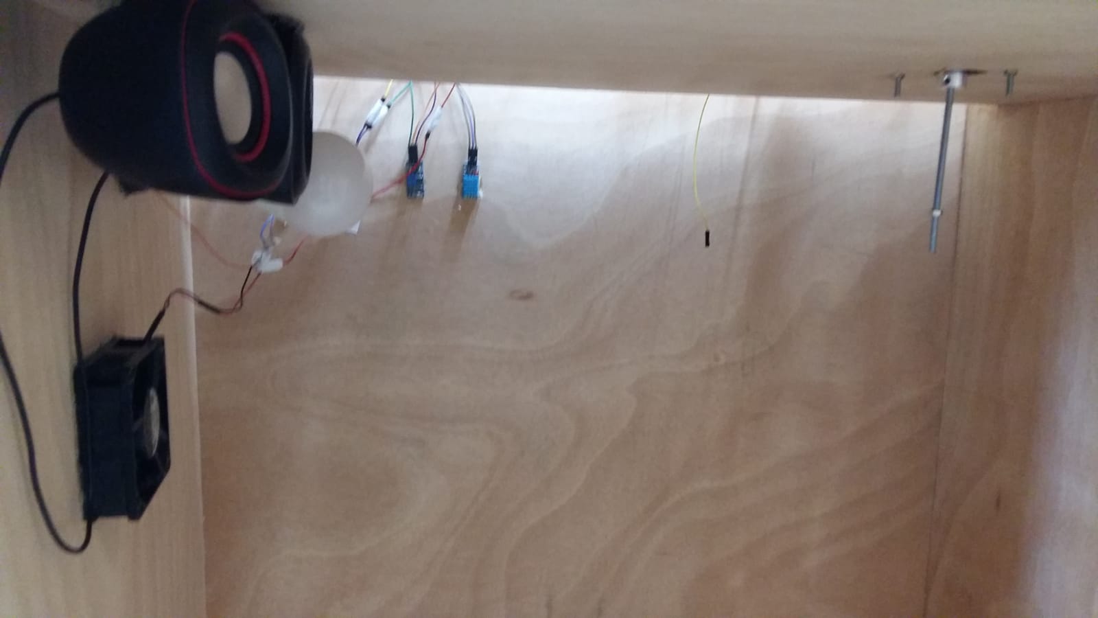

im using SD card module with arduino mega to play audio using external speaker. everything is working fine, and im reading Temperature sensor and LDR, a fan and bulb are connected, if i try to digital write or analog write to the fan or the bulb, the audio becomes corrupted and just gives noise sound, any idea why?
im using pin6 for audio output, pin 23,2 for fan and bulb(connected to relay)
Could be a power supply problem: the fan and relay draw (relatively) large amounts of current, and this is causing your supply to "sag" or "brown out" - which messes with your audio module.
As a test for that, what happens if you just disconnect the fan and/or relay?
Please post your schematic, and some good clear photos of your setup.
yes bro, i think you are right, its about the current, how to fix that?
i tried to disconnect the relay as u said, and wrote digital high to the pin and the audio kept working properly, so yes it is as u mentioned.

there u go
The bit about "star" connection.
Did somebody mention photos?

i uploaded the photos, i hardly doubt that u will get any benefit from that :smiley:
but u insisted xd
i think the problem is obvious bro, as u mentioned in the first answer, its that noise, i just need help remove that noise
There are too many unlabelled connections and "black boxes" (where you can't see the internal connections, components are generic, like "Relay".
If you want help, you have to step up and provide details. The photos are a start, but it would be a significant job to understand what the connections are, just looking at those. A proper schematic (or system wiring) diagram does that, nothing else does.
