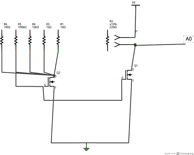

i have been reading up on current mirrors and i am still not fully sure what i need to do.
your talking about using a circuit like this, and i think, between Q2 and RE is where i should take analogRead()
am i on there right track?
why would i use SMD rather then a something i can solder with out a reflow or a microscope?
why pnp rather then npn or mosfet?
the Wilson current mirror that you linked to uses three npn transistors. i am getting a little lost in the math of how to solve for load.
i understand that i set current with R1. i have the unknown R between the collector of Q2 and ground. then analogRead at Load float=(5.0/1023.0)/(setAmps) am i understanding it right?
eliofall:
I have been reading up on current mirrors and i am still not fully sure what i need to do.
It should boil down to "just use the circuit". :smiley:
eliofall:
your talking about using a circuit like this, and i think, between Q2 and RE is where I should take analogRead(). Am I on the right track?
Err, no. In that circuit, the important thing is that the two RE are equal. The i1 source sets the current and the mirror feeds (or sinks) the same current to i2 which is where you put your measuring terminal which is also where you measure the voltage. The trick is that using a resistor to set i1 requires it to be calculated for the voltage drop which then depends on the Vbe of the transistors (about 0.65V) and the drop across RE. Essentially your resistor plus RE will correspond to the supply voltage minus Vbe divided by the desired current.
But another problem may be that you want the voltage across RE to be significant to make the mirror work at its best, so you are losing more voltage than you might prefer to. The "Wilson" mirror loses much less voltage on the "Load" side (though R1 must be calculated on the supply voltage minus 2 times Vbe) so would be easier to work with. Transistors are really cheap.
Do not be confused by the fact that the transistor with collector connected to base is on the opposite side in the two circuits - that is precisely how they work!
eliofall:
Why would I use SMD rather then a something i can solder with out a reflow or a microscope?
Because they can be mounted much closer on a PCB to ensure thermal compensation. Maybe that matters, maybe it does not, or you can get transistor packs designed for the purpose with both (or the Wilson three) transistors in the one pack specifically for this purpose - they might actually be leaded (such as in TO-3 cans!) or SMD.
eliofall:
Why pnp rather then npn or mosfet?
Because you have to turn the circuit upside down so that the load goes to earth as does "R1". MOSFETs have too high a VGS threshold to be used at 5V.
eliofall:
The Wilson current mirror that you linked to uses three npn transistors. I am getting a little lost in the math of how to solve for load.
I understand that I set current with R1. I have the unknown R between the collector of Q2 and ground. Then analogRead at Load float=(5.0/1023.0)/(setAmps) am I understanding it right?
I think that is correct.
Again, the math is dead easy. Do remember that it is turned upside down, so that all are PNP and the emitters of Q1 and Q2 are going to 5V (you could use a higher voltage if it was accurately regulated). The unknown and your analog measuring input are on the collector of Q3.
Each R1 switched to ground will be supplied by 5V minus 2 x Vbe (the drop of Q2 plus that of Q3), so 3.7V. That allows you to calculate the values. That's all the math you need to know (just as well since I have not looked into it in any more detail myself :D).
