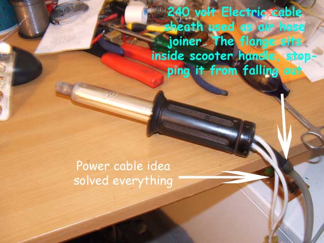

with some pipe, a scooter handle and a hacked up heatgun you can fake one
I saw that when I was trolling around for ideas on how to make this work. I have the heat gun I'd want to use. The heat gun isn't the problem.
