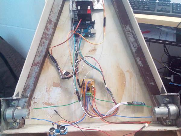

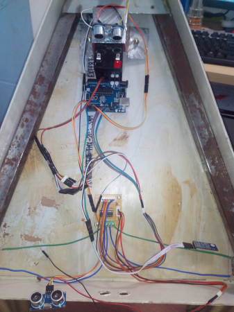

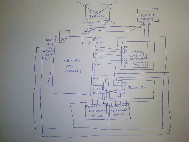

I used a 12V 1.3A battery for motors and a 6V 1.2A battery for Arduino. I attached the circuit diagram below.
Sorry, but it is almost impossible to figure out wiring connections from photos of the project hardware. Make a pencil drawing of the circuit and post a photo of that.
Your power supplies seem to be adequate.
Have you a GND connection between the two power supplies?
...R

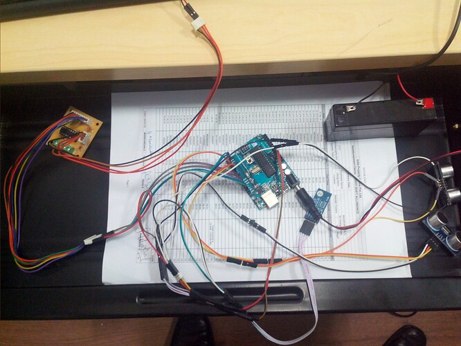

Added the circuit like you asked below.
I attached the circuit diagram like you asked.
abish_r01:
Thanks for the drawing. That makes things much clearer.
I wonder if the supply to the Arduino needs to be higher than 6v? The recommended voltage range is 7v to 12v.
Could you temporarily swap the 6v and 12v power supplies?
...R

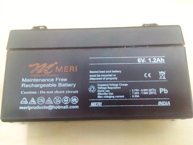

Excuse me. I made mistake. It is 6V 1.2Ah and 12v 1.3Ah. I bought the battery from local market. So don't have any link to share.
What is the minimum and maximum current supplied to Arduino and to the motors. Your advice will be very helpful to me.
Below is the image of the battery. What is the Amp in my battery. It has only charged with 0.36A. How to find the A of battery?
Very thankful to you.
That is a lead-acid battery. It will provide a huge current if required. Lead-acid batteries are ideal - but do make sure you don't leave it discharged for any length of time as that will greatly shorten its life. Ideally recharge immediately after every use. It's a good idea to have a fuse (perhaps 5 amps) near the battery terminal otherwise an accidental short circuit could cause a fire.

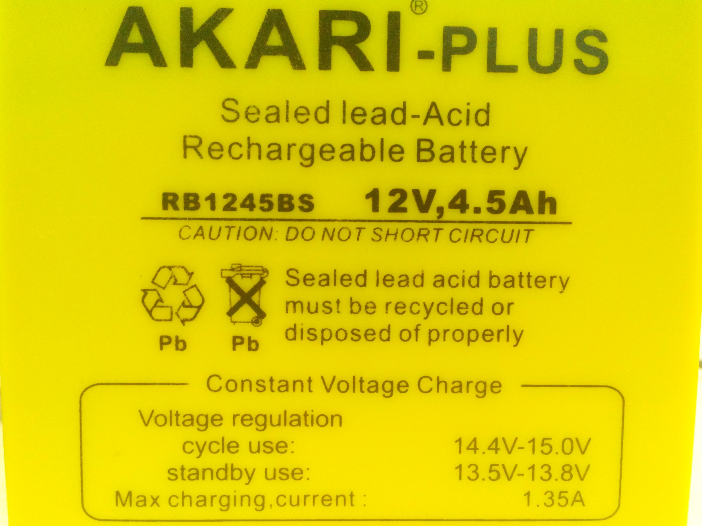

I tried with charged old battery of 12.8V, still no possitve. I bought a new battery with 12V, 4.5Ah and charged from 4 hours. It has 13.5V now. I tried with that also. Still same problem happening. Below is the image of the battery. Was the L293 motor driver had problem of getting power from battery?
Will the L298 motor driver work?
Let's go back to basics.
Does the project work if the Arduino is powered from the USB cable and the motor is powered from the 12v battery?
Does the Arduino work (without the L293 connected) if it is powered by the battery rather than by the USB cable. If necessary add some flashing LEDS so you can be certain.
When BOTH of those situations work properly ...
Does the Arduino work with the L293 connected if the Arduino and the L293 are powered from the 12v battery - use the flashing LEDs for confirmation.
Does the Arduino work with the L293 connected if the L293 is not asked to do anything - i.e. a check on interference caused by the motor
I note in your diagram that you seem to have the GND from Bluetooth and the GND from the L293 connected together before they connect to the Arduino. It may be worthwhile giving the Bluetooth device a direct GND connection to the Arduino.

1,2,3,4 all tried, worked perfectly. Motor is also running with l293. But I integrate sensor, bluetooth not working.
Yes for (5) I made a common connections like in the below image.

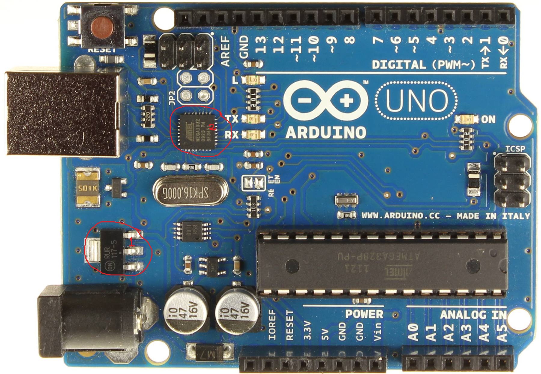

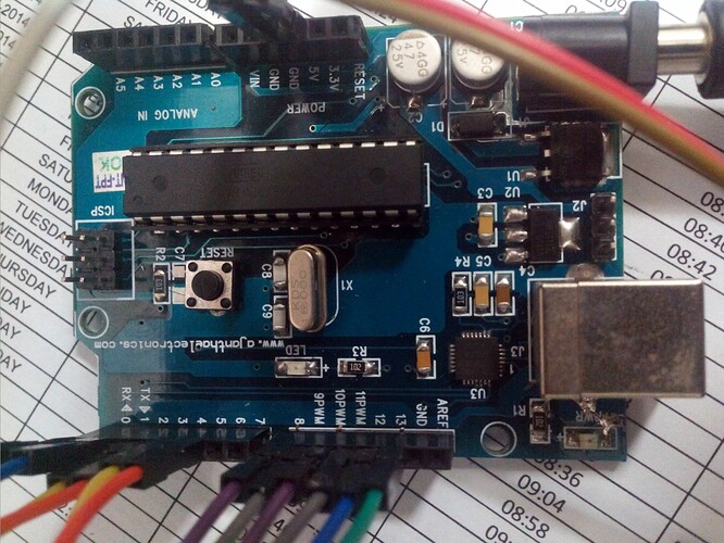

Sorry for the late reply. I got some problem with Arduino. Two IC getting heated always. 1 while giving power from 4.5Ah battery and 2 heating while USB connection. What is going on in my board. I'm confused totally.
Before that I changed the Bluetooth(Old Bluetooth is got faulty). My project works fine for one moment. After that Arduino was not working properly. So I ordered new original UNO. Can I use the same 4.5Ah battery?
Attachment is below.
abish_r01:
Without a detailed wiring diagram it is impossible to answer that. You don't even say which ICs were overheating or what voltage battery you were using.

Robin2:
I didn't connect anything with the Arduino. Eventhough it is heating. I circled the IC which was heating in that image I uploaded. The ICs are 78M05G, CP2102.
I just connected the USB cable to power up Arduino, the IC CP2102 is heating.
Again I tried with 4.5Ah 12V Lead battery the IC 78M05G is heating.

I tried one by one like you said. Finally I found bluetooth shield is the problem. After changing the bluetooth my Arduino get faulted next day. Arduino is overheating and Atmel atmega8 chip verification error.
