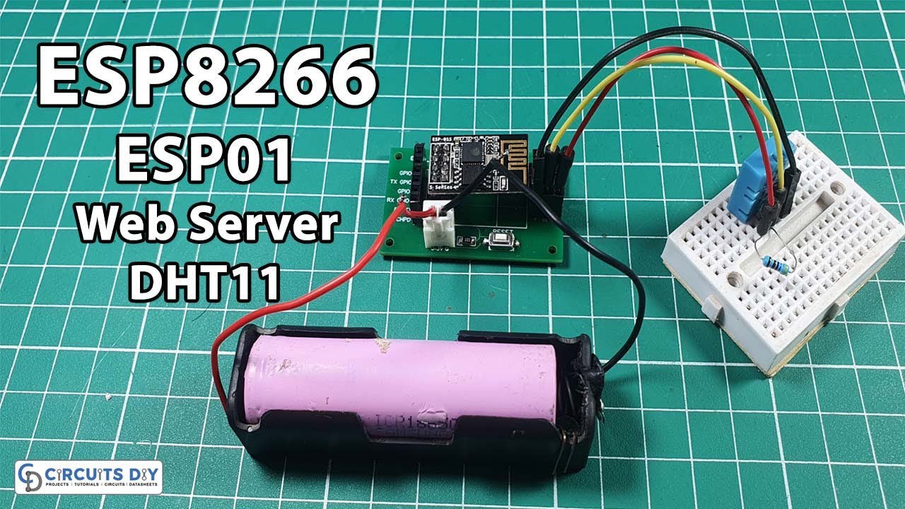

Suggestion: ESP8266 is a standalone MCU and DHT 11 can work at 3.3V. Why don´t you connect DHT11 directly in the ESP?

Take a look at these ideas:
https://www.youtube.com/watch?v=Xfs-woLjhLA
