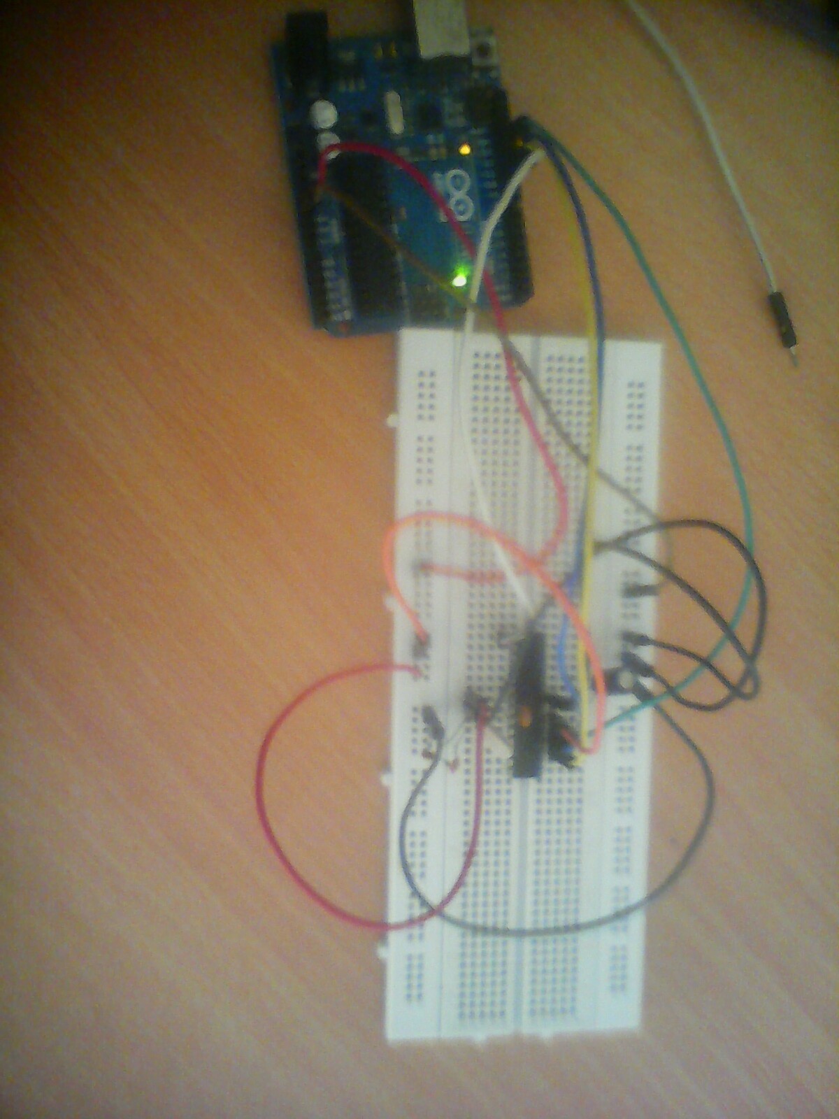

Oh well.... the image you provided "looks right", but there's no way to compare what your board is actually wired like.
Do you have an oscilloscope? Can you tell if the oscillator is running? You should see about a 1 volt P-P sine wave at 16 mhz on either pin (in low power crystal mode) and about 3.5v P-P in high power crystal mode (both centered around 1/2 VCC).
Did you check key voltages? Reset pin high, both VCC high, both GND low, AVCC and AREF either at VCC or open?
Can you post a picture of your setup, not a fritzy, so we can see your layout.
Thanks... Tom... :slight_smile:

Please find the attachments. AREF open need to connect to VCC ?.
Avcc tied to VCC
Both vcc tied and 5volt connect arduino
Both gnd tied and connect with arduino
reset pin goes to 10 pin of arduino. and no 10k pullup tied to vcc. need a 10k pullup ?.
these all are done erlier. I was fighting with this bootloader last 3 days.
Yes I dont have oscillscope.
I checked using cheap multi meter. one pin gnd and one is crystal leg. I got 0.75 volt
Yes, 10k pull-up is needed.
No! You can connect it via 100nF capacitor to GND for decoupling but it is not needed for this use. Let it not connected.
10k added But same error.
my UNO have Atmega328P-PU but my bread board atmel Is ATmega328PU only Opti bootl problem.

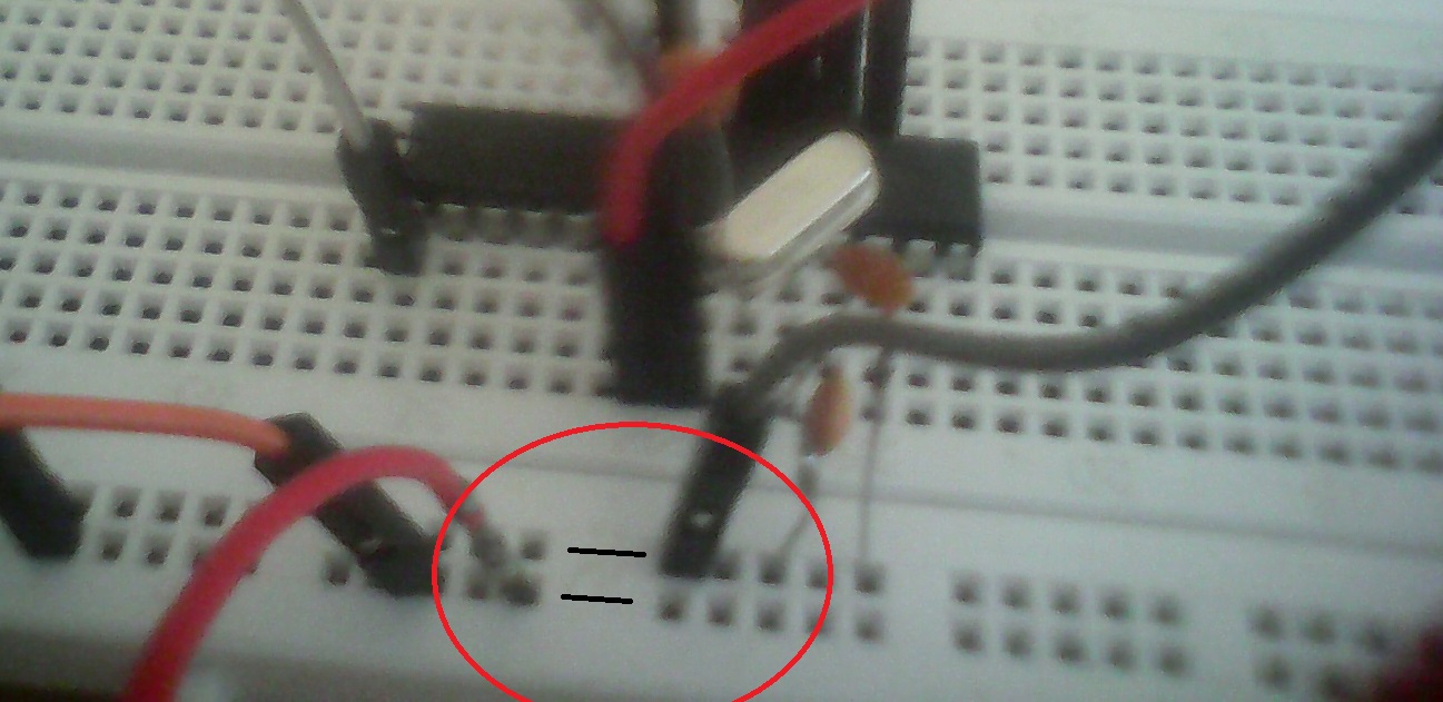

I am using one half only for my circuit in my bread board.
SureshKumar2610:
But this pic shows you using both halves.
See if you gnds and 5V are continuous, check continuity where black lines drawn.
Tom.. :slight_smile:

Again I rechecked my bread board circuit. I got 4.56 volt two sides.
5V to AVCC,VCC
GND to GND two sides
AREF open
10 ----1-----10k pull up required ?
11-----17
12-----18
13-----19
9,10 crystal and 22pf 2 capacitors.
Do not cross-post. Do not hijack. Offending post removed.
Your wiring is wrong because of reading zeroes. It means that the target MCU does not responding at all.
This is not good. See the post #5 and 14.
Again, 10k is needed.
Another thing you can test with DMM is reset signal at the start of uploading. Pulse is short about 200ms but it should be visible as short voltage fall on reset pin from stable 5V.
Back to the oscillator circuit. There is possibility that something is wrong. You can disconnect caps and xtal, and use clock signal from UNO pin 9 to ATmega's XTAL1 pin 9, but you have to modify ISP sketch. For this functionality read this thread: Arduino as ISP - strange behavior (?) - #9 by Budvar10 - IDE 1.x - Arduino Forum, post #5.
