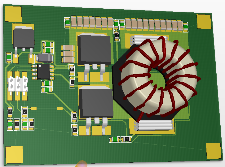

I was contacted by a few people who wanted some info on my original buck converter shield. Unfortunately i didn't get the time to finish the project and haven't touched it since. I have decided to update it using better parts and refining the design and i thought I'd post my progress.
Specs are
Aluminium pcb for easy heatsinking
Synchronous converter for over 95% efficiency
Single PWM input with built in dead time compensation
40v maximum input
Input and output voltage dividers for in and out voltage measurement
Here is the layout so far.
Original buck converter thread
http://forum.arduino.cc/index.php?topic=190642.0
I have done some more work but still not finished. It is very hard to do a design like this on a 1 layer aluminium board and still optimize the layout. Proper placement of buck converter components can maximize efficiency and reduce unwanted ripple currents.
I'd love to see some examples of surface mounted mosfets on aluminium boards but there just isn't much info out there.

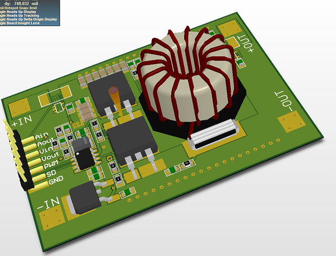

The board is now finished.
I have added input current measuring and output current measuring. I hope to use it in a small MPPT so this is needed!
Iv'e also added thermal vias so the pcb can be mounted to a heatsink to remove the heat.
I have done away with electrolytic capacitors altogether. I'm hoping some x7r ceramics will do the job by themselves.
Now I just need to order the PCB so I can build and test!

Today I received the PCB's and quickly threw one together. Please excuse the lack of alignment of the components as i didn't have much time. The buck converter works quite well except for the lack of input capacitance. I had to add a bulk electrolytic capacitor to stop ringing in the mosfets at high loads.
Test was done with down light globes as a load. At 85 watts load the current was around 11 amps which was the limit of the inductor. The mosfets get to about 50 degrees without heat sinking. I briefly tried clamping the board down to a heat sink with an insulating mat in between and the temperature dropped to a bit above ambient temperature.
I also tried bursts of 330 watts which was about 20 amps on the output. The unit handles it fine but will heat up very quick.
