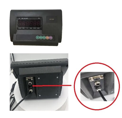

@mlouise16 can you tell us you have a weighing platform upon which that to be weighed is placed, that is already part of or connected to the thing you are trying to analaogRead from?
Maybe snap a few pictures showing what you are dealing with. Include pictures of the ports or jacks and the buttons and the display so it's almost like we have one ourselves.
a7
The serial output is not from a DB9 connector, but from a 5 pin circular connector.
Here is a photograph I managed to find of the connector:
Most photos seem to show a fuse holder in the position occupied by that connector.

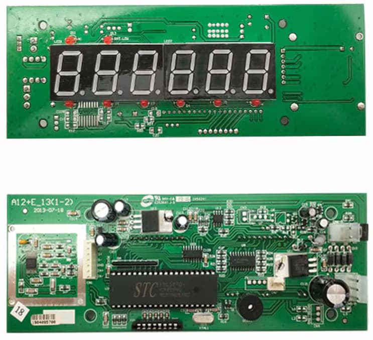

Can you load an image of the inside of the weight indicator (Yoshua XK3190-A12E)?
I expect it has:
There is another version without the RS232 connector (see bottom edge on right GND, TXD, RXD):
The RS232 version also has extra components on the flip side underneath the first 2 digital segments, probably including a 16-pin MAX3232CSE DIP with it's supporting resistors/caps.
Can the A12E-NoRS232 board generate TTL data? Does it need supporting components? What about VCC?
