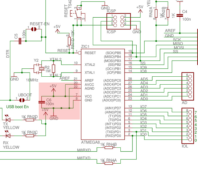

If you look at any arduino schematic, you will see "large" caps (47uF, 100uF) on the regulator input & output, that was the caps I was referring to. The 100nF goes across the atmega328 VCC & Gnd pins close to the chip itself.
If you look at pin PB5 (19, which is D13), you will see a series resistor with the LED. You want that.
Unless you know for sure your LED has one built in, operating without the resistor will lead to either a damaged LED (cheap) or a damaged output pin(replacement ATMegas ar $5.50 - not so cheap). If your atmega feels hot to the touch when running, that is a sure sign that something has been damaged.
There is also a 100nF cap across Vref to help that keep noise down if you are making analog input measurements.

The parts I am talking about on the schematic are:
PC1, PC2, these are like the 22uF cap you have by the regulator now. That is good. Get another one of those.
See figure 1 here:
100uF might be overkill, but it won't hurt. I've been using 1uF on the input and 0.47uF on the output, but only because I had a bunch on hand.
Move the little cap across pins VCC & GND over by the crystal the way that C6 is connected up.
Wire up a current limit resistor the way that RN2A is connected.

There you go! At the best, you will find the "Reference Designator" (also called Ref Des) on the parts easily, at the worst we will have to copy part of the schematic, add some arrows & red circles or something & post a revised picture for you. There are not many parts to look at tho, I am sure you will find them.

OK..I checked out .pdf as you suggested..
found the C6 portion.. (but being so new I cant 'just wire it up the same way' unfortunately)
Im a bit confused....
1.) as to 'WHY' this is needed....
2.) why this isnt/wasnt included on these barebones/minimal Arduino clone/circuit tuts I see all over?
(and still a bit un-clear on this series resistor comment you made.. just want to ensure I am doing thing proper..a bit hard when Im 'following' at this point.. =( ..however I do appreciate your help/advice.. gotta sink in eventually) =)
so on the diagram posted (C6)..
I see there is/are other lines/traces tied into this 100nF cap across the VCC & GND pins?
Is this something I need to deal/worry about? Kind of confusing..(the diagram)
Your suggestion. is it as easy as just putting a 100nF cap across pins 7 (VCC) & 8 (GND)?
after the I/O pins..before the jumper wires, tying into the rails?
(still unclear as to what to do with those other lines 20 (Avcc) & 22 (GND) ??
(and again..my brain is stuck trying to figure out/worry about this series resistor you mentioned?)
when thinking about.. I think your just saying.. ALWAYS USE A RESISTOR on LEDS like that?..
"OR" are you saying.. I need to have this series resistor as part fo the circuit for other reasons? as a base part of the Arduino 'circuit' itself.. regardless of the leds or other external components that may be used?
In the end.. I will implement the rule of 'always use a resistor'.. but I dont want to confuse myself on what is required to build the base circuit.. and what is needed for when I add 'blinkies/buttons'..etc..

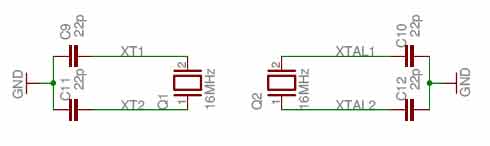

I am a bit confused on this:
2 different (same) crystal wiring diagrams?
looks to be mechanically the same? (same resistors used...same layout?)
but the name for the xstal is different?
That I need any more confusion..LOL.. but it was bugging me?!
Thanks

Ok, good to see you're keeping busy.
  1. Your photoshop is not correct. You Vin going to an empty row (if you call the groups of 5 pins rows), and GND going to the Vin pin on the regulator. Need to slide those down 1 hole each.
  2. Power for pin 7 is going alllllllll the way around the board before it gets to pin 7. The cap to ground (pin 8 ) is there to ensure a clean supply voltage, especially
    with the 16MHz oscillator right there. The other lines show that these pins are connected to VCC, AVCC and AGND on the other side of the chip (power for the Analog parts of the chip). If you are planning on doing any analog functions, I would recommend a cap across pins 20 & 22 (AVCC) and 21 and 22 (ARef, see C4 at the top right of the schematic) for cleaner analog operations.
    "Your suggestion. is it as easy as just putting a 100nF cap across pins 7 (VCC) & 8 (GND)?" Yes.
    "after the I/O pins..before the jumper wires, tying into the rails?" Right across pins 7 & 8.
3.The series resistor, seen in the upper right of the schematic as RN2A (or RN2B) should always be used with an LED to keep from burning up your output pin. It limits the amount of current that will go thru the LED. They put an extra set of pads to allow a choice of parts. The LED turns when the output goes to 5V and either it will burn up or the output pin will burn up if left on long enough.
You don't need that LED at all - but it is the activity indicator used for the basic sketches & bootloader so you when download those you can see that the circuit is alive & well.
  1. The other crystal part - if you look closer, you will notice above C6 there is Y2 (and XTAL1 and XTAL2). What this is is 2 sets of pads; 1 set for a 16MHz crytal Q23 and its two 22pF caps, and 1 set for a 16MHz Resonator and 1Mohm resistor that is used with it. One or the other are used. You have a crystal and caps, no need to worry there.
    The Q1/XT1/XT2 are for the other uC chip that does the USB interface (vs an FTDI chip).
