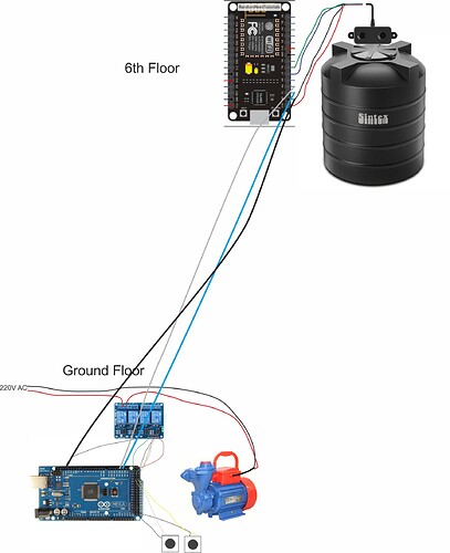

Arduino Cloud switch On/Off not functioning
@outbackhut
connections, wiring, power supply all is ok.
if i press the button motor turns on and off, works perfect & update switch status in Arduino IoT Cloud but when I turn On/Off from Arduino Cloud, it does nothing neither turn off while on nor turn on while off
there are 4 relay connected to arduino mega but i am putting command for 1 switch to find out the problem
Arduino code

Are you saying you have wires connecting everything - six floors apart???
