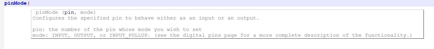

I am currently working on an external plug-in but for now this Portable version will give you auto completion and function hints for standard Arduino code... I'm working on adding the other libs but it is time also consuming.

thanks for you input ... ill update the post... i need to look at setting npp to open the IDE and compile but this depends on where the user puts the .exe easier for me to just explain that you open the ide and open the file you want and hit compile... the npp is just there for help writing the code... i will also add descriptions of each function to the call tips
