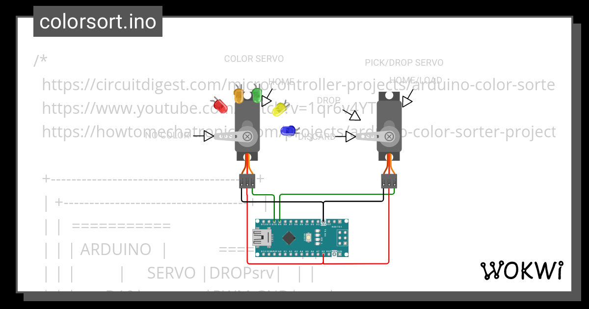

The Bottom Motor is on but not working. As Sensor motor is detecting the color but not accurate as per code/tutorial

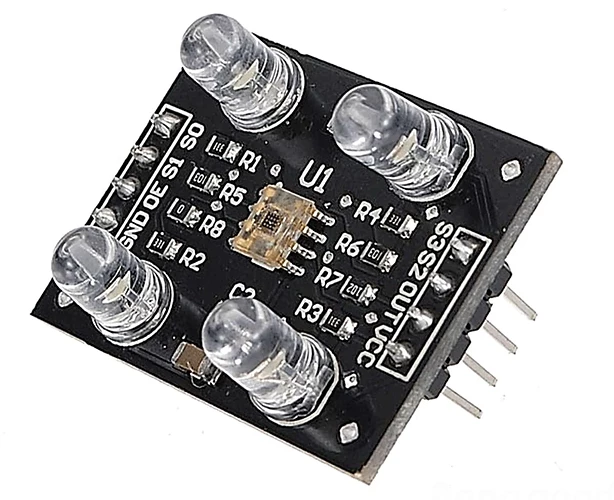

I'm using this sensor for my project build
What color do You get here?
R= 289  G= 370  B= 313
R= 284  G= 360  B= 298
R= 285  G= 357  B= 305
R= 286  G= 344  B= 300
R= 283  G= 358  B= 309
R= 282  G= 359  B= 297
R= 283  G= 361  B= 305
R= 282  G= 342  B= 301
R= 287  G= 364  B= 300
R= 278  G= 365  B= 303
R= 289  G= 366  B= 312
R= 290  G= 369  B= 310
This type of values, serial monitor is showing
i think the code is not correct for my sensor
means? I don't how to see the color that it is showing
Print the value of the color returned from the resdColor() function.
And what values of raw R, G and B do you get with your red, green and blue test colored items? The lost you posted is meaningless if we don't know what was being sampled.
a7
Did you read the example you linked?
Here are the RGB values that I got from the sensor for each skittle. Note that these values can vary because the sensors isn’t always accurate
YOU must make an accurate range for YOUR colors. You also need a plan for "no color"
