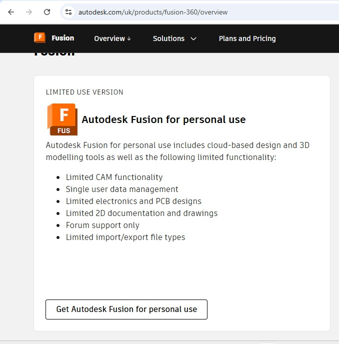

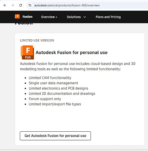

There is a free, limited functionality version of Fusion for personal/not for profit users.
Just the same as there was for Eagle.

Thanks for info, I am aware of the limited feature, just a newbie to Eagle CAD XD and wanna see it can open or not :slight_smile:

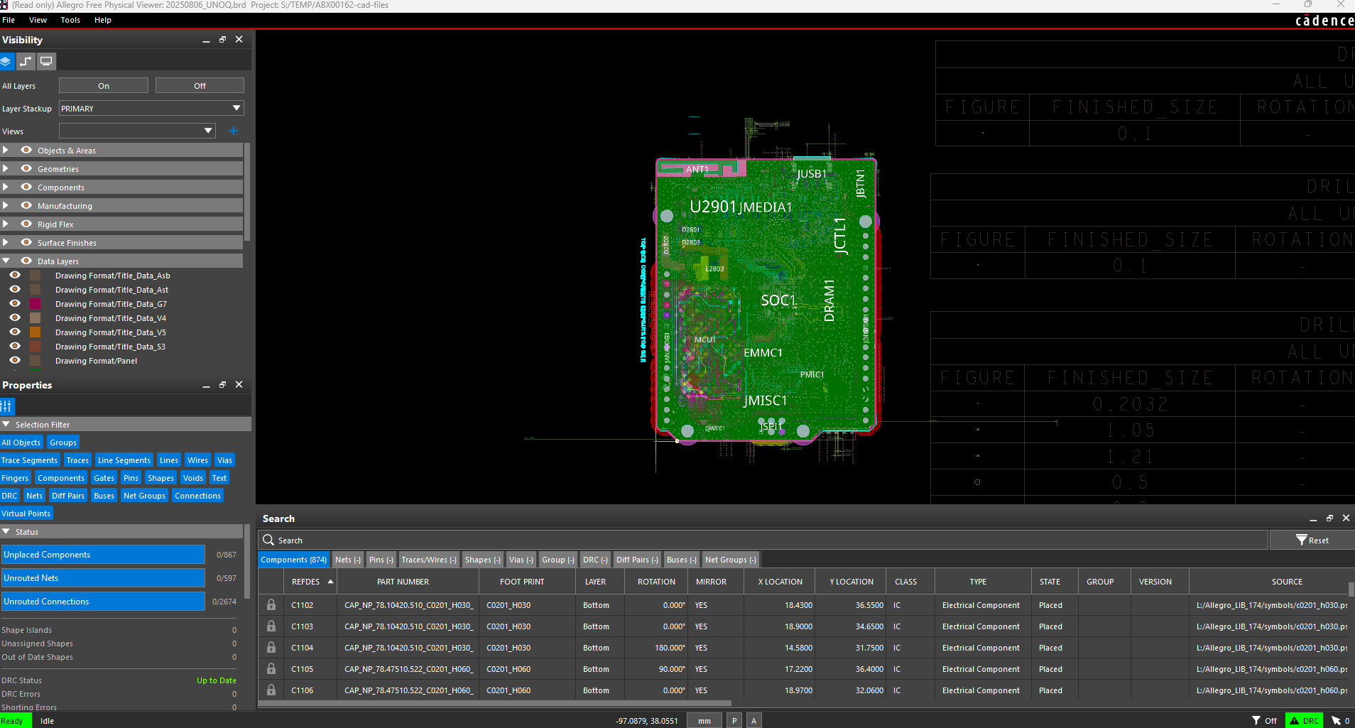

Thank you for the feedback, just tested and able to open the .brd file as shown below,

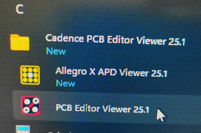

Just some info on installing the Allegro X Viewer, in the .zip file downloaded, just double click the PCBEditorViewer.exe to run and install.
Next, run the PCB Editor Viewer 25.1 as shown below then open the .brd file,
Personally, not sure merely with this viewer without editing can benefit anything.
Anyway, thanks again.

It depends on the use case. For someone who wants to create a derivative design based on the UNO Q PCB, it is certainly less useful (though still better than nothing).
However, I think there is another significant use case for the file: some of us have no intention of making our own PCB, but may still want to look at the design in order to gain a better understanding of the UNO Q hardware. In this case, a read only view is perfectly sufficient.
