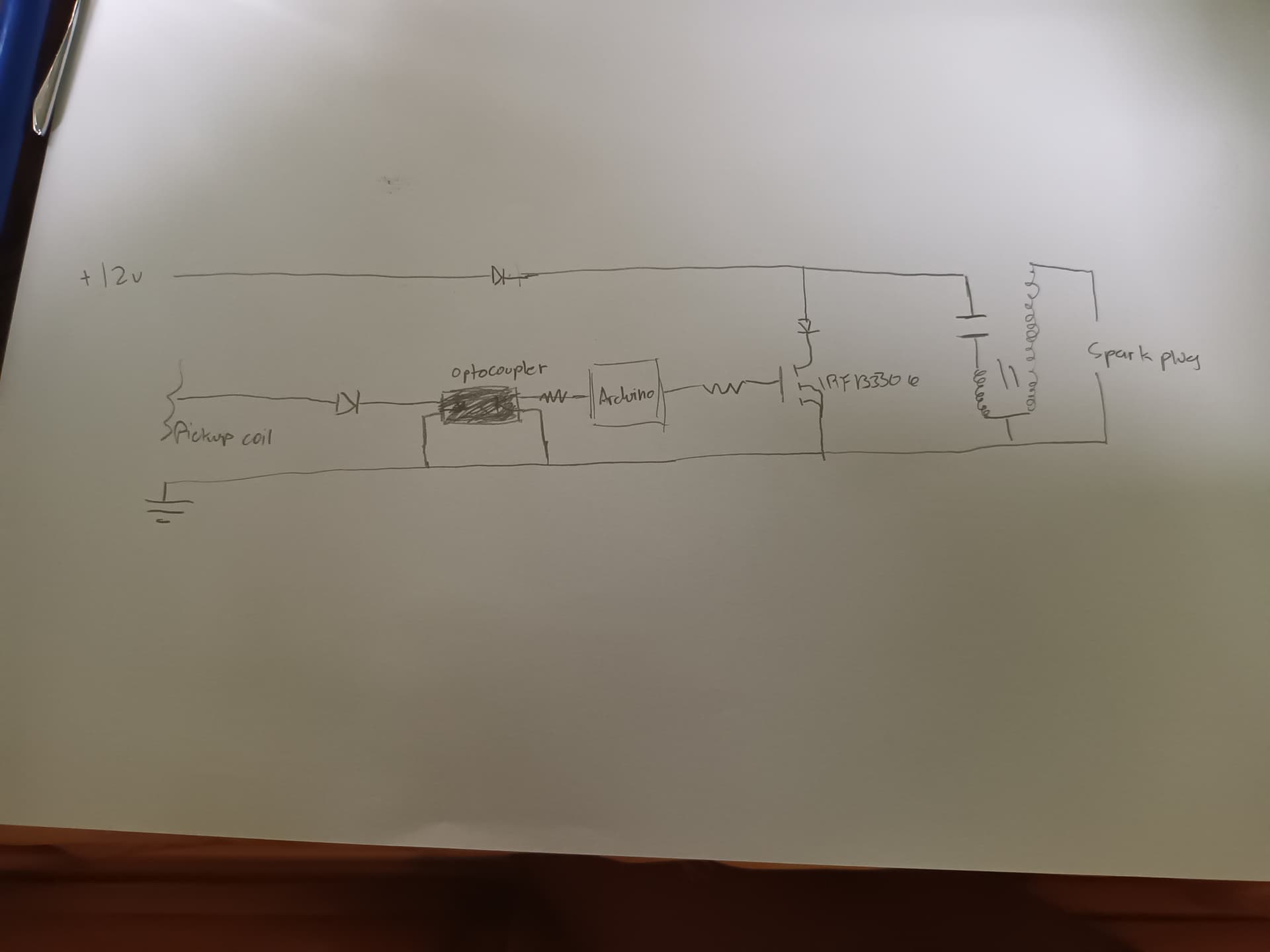

It's my first project and I don't know what I'm doing but does this schematic make sense?
Welcome. From the perspective of understanding the schematic, I understand how you intend to make the electrical connections. As for whether the circuit will function as expected, I do not have enough information on your project to determine that.
Please take a look at this link explaining how to best use this forum for help with your project:
Without knowing anything about the hardware involved, hard to tell how the optocoupler will handle the coil pickup. On the output side, appears to be a regular engine ignition circuit but not enough information to determine how the IRFB3306 device will perform with the other parts.
Please provide as much information as possible about your project and the hardware involved as described in the link above so we can help you. Good luck with your project.
No.
Look at this, for example. It is usual to use an SCR (Silicon Controlled Rectifier) in such applications. I've used a similar circuit for an electric fence type application controlled by an ATTINY85.

You find many more examples here: motelek.net - Die Motorradelektrik-Datenbank Some of the text is in German.
