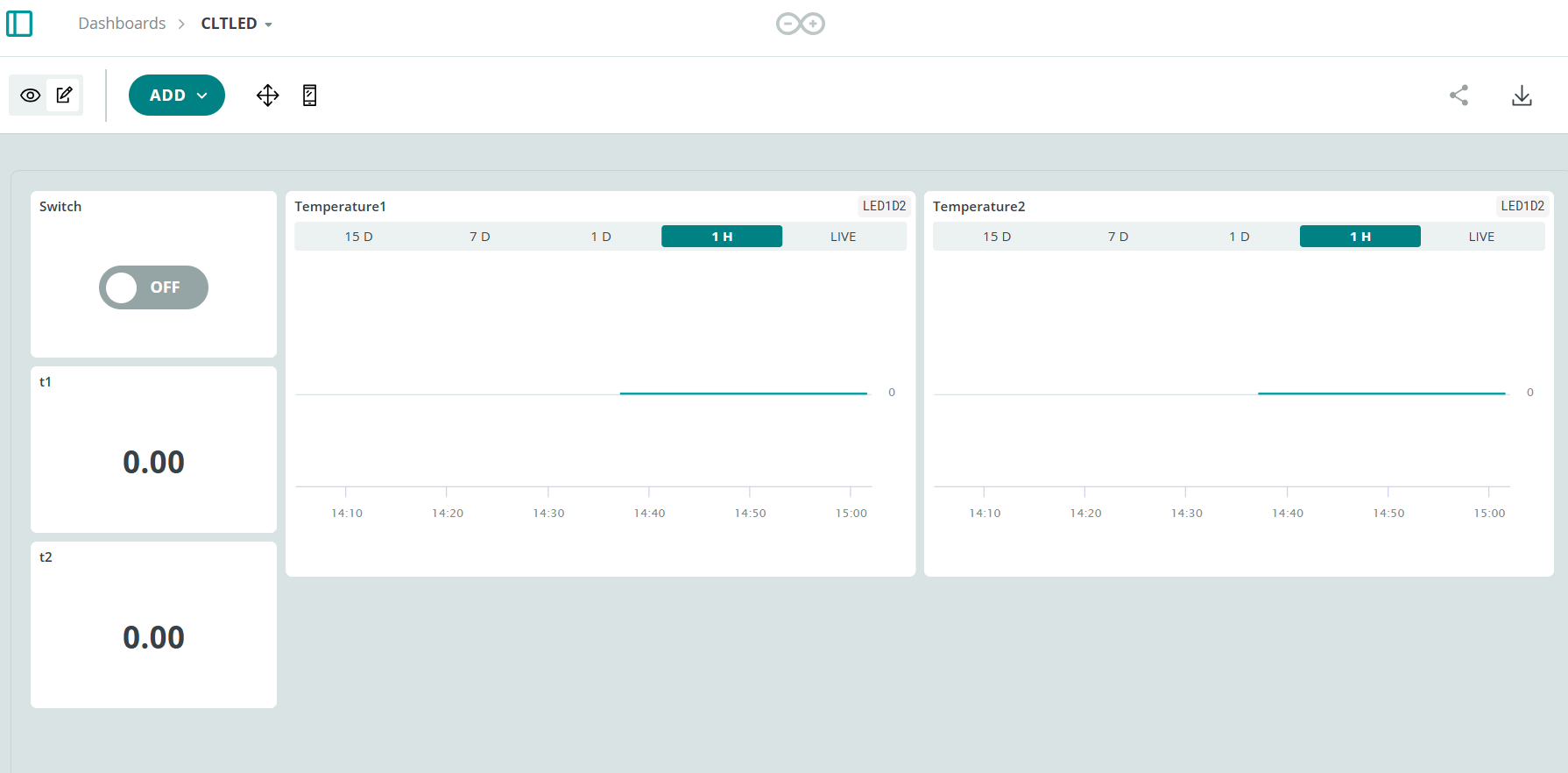

Arduino could dashboard not shown temperature data

I updated my sketch to arduino r4 wifi The temperature can show on LCD and Serial monitor but show 0.00 in my dashboard Can anyone help me. Please.

Hi @warachai. I'm going to ask you to provide some additional information that might help us to identify the problem.

Thank you for your answer. My Arduino uno online and I can control 1 LED. via my dashboard however the data of temperature shown 0.00 but in serial monitor and LCD can show the actual temperature.
Thank you for your help. I am sorry for my mistake.
I don't spot any problems in your code.
I have found that sometimes the connection between the dashboard widget and the Arduino Cloud Variable can get broken. Try deleting the nonfunctional widgets from the dashboard and then add them back again. Hopefully they will start working after that.
Thank you for your suggestion. I checked and found the mistake with my parameter which I declare may concern with autometic generate form variable configulation in could.
after I delete and using the parameter from autometic generate the dashboard shown my temperature data. Thank you.
