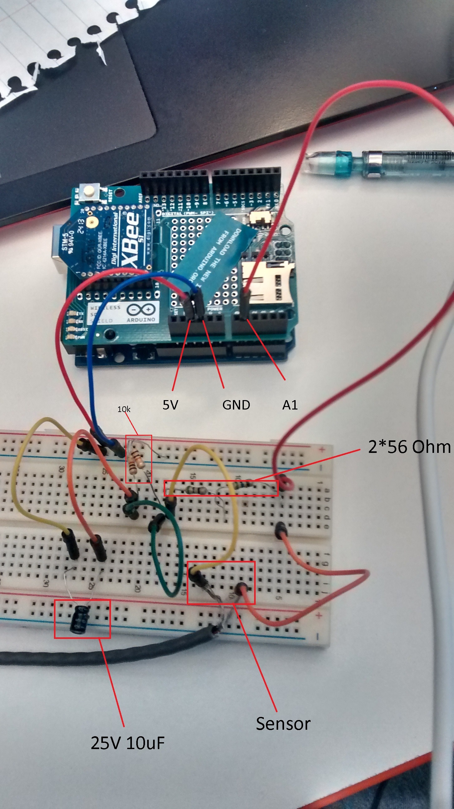

This is the circuit:
This is what i have done:
When i connect sensor to circuit, results around: 32 A
When i disconnect it, results around 9 A
when i disconnect A1 input pin, results around 3 A

Try to dump the raw A1 values. analogRead(A1) should be constant (~512) with the sensor removed.
Find attached a schematic of your project.
The circuit biases the current transformer so with no current V1 has half Vcc or 1/2 of 5Vdc= 2.5V.
When AC is conducted through the transformer, the output will be an AC signal on the 2.5Vdc.
The library converts this reading to RMS.
With the coil disconnected your should have 0 Arms.
Tom… :slight_smile:

I hope you aren’t trying to measure DC Current, this unit only measures AC current.
you have lots of jumper wires to connect the different devices.
you have 10k highlighted but boxed over 2 resistors.
looks like they are supposed to be two to create a voltage dividor. I assume that the note should be 2x10k
it also looks like the green jumper from the voltage divider is next to the yellow that connects to (or is supposed to connect to) the voltage divider.
I would re-visit that connection.
I just modified the circuit :
Then results:
-when sensor is not connected: around 0.3A
-when sensor is connected: around 1.4A
-when A1 pin is disconnected : around 3A
What could be the problem?
The problem can reside in the library or in your circuit. Try debugging without the library first.
