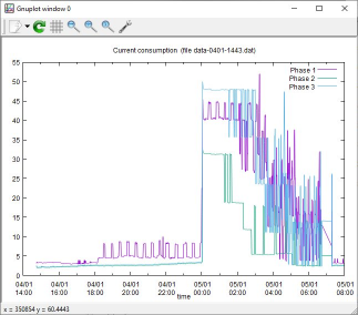

I have used a ESP32-4-Channel-Mains-Current-Sensor with three SCT013 100amp sensors to monitor house 3-phase current consumption
e.g.
the 4-channel sensor PCB contains the circuits to offset the SCT-013 AC reading so it can be read by the ESP32 ADCs (approximate input range 0 to 3v)
you have to sample ADC readings over several cycles to get the RMS value

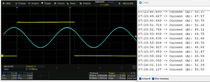

Here are the results, displayed on an oscilloscope and the serial monitor simultaneously.
  • The yellow trace indicates the width of the sampling period.
  • The blue trace is a 50Hz sinewave injected into pin A0.
Input amplitude = 1V RMS, to simulate a current of 50A RMS:
Input amplitude = 500mV RMS, to simulate a current of 25A RMS:
The results vary slightly from the expected 50A/25A.
I believe this is due to the sampling period not being exactly one whole period of the waveform.
If you take the average of all the values displayed on the serial monitor then the results are pretty accurate:

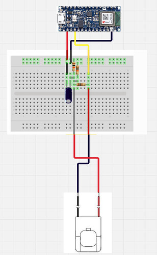

Sorry for the late ansewer, i have forgot to put the schematic of my application.
Here's the schematic
My burden is 1 ohm and two resistor are 10Kohms with a capacitor of 10ยตF

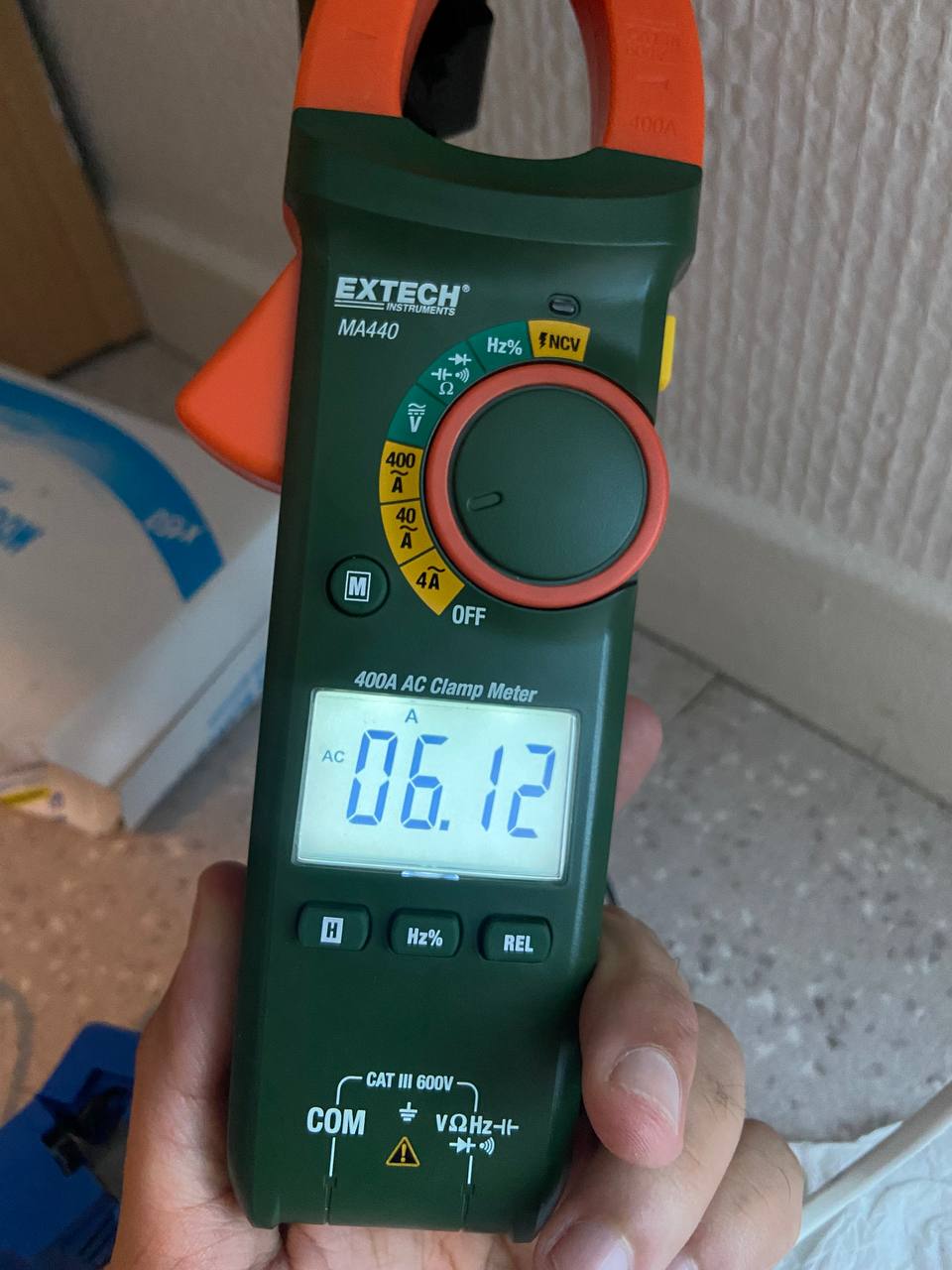

checking the accuracy with a current clamp meter readings are within a few percent

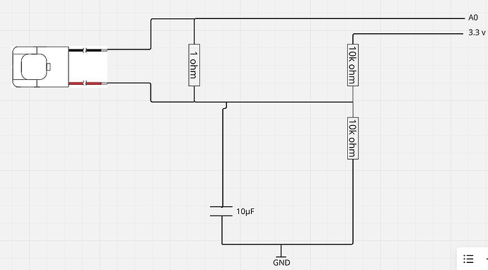

Here's a new schematic :slight_smile:
No i use CT without a burden resistor and it's not SCT-013, I know that SCT-013 has already a burden resistor.
Here's the link of my CT : link to the product
The datasheet for the current transformer doesn't mention a burden resistor.
I think that the fact that the 5A versions use a thicker gauge wire than the 1A versions indicates that the burden resistor is user supplied.
Don't try using the current transformer without a burden resistor - dangerous voltages are generated.
I can confirm that your schematic matches the schematic suggested by openenergymonitor.org, with the caveat that you are using a reference voltage of 3.3V, not 5V.

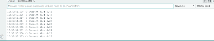

Here's some results :
the expected value :
The value of CT with arduino :
Using this schematic :
