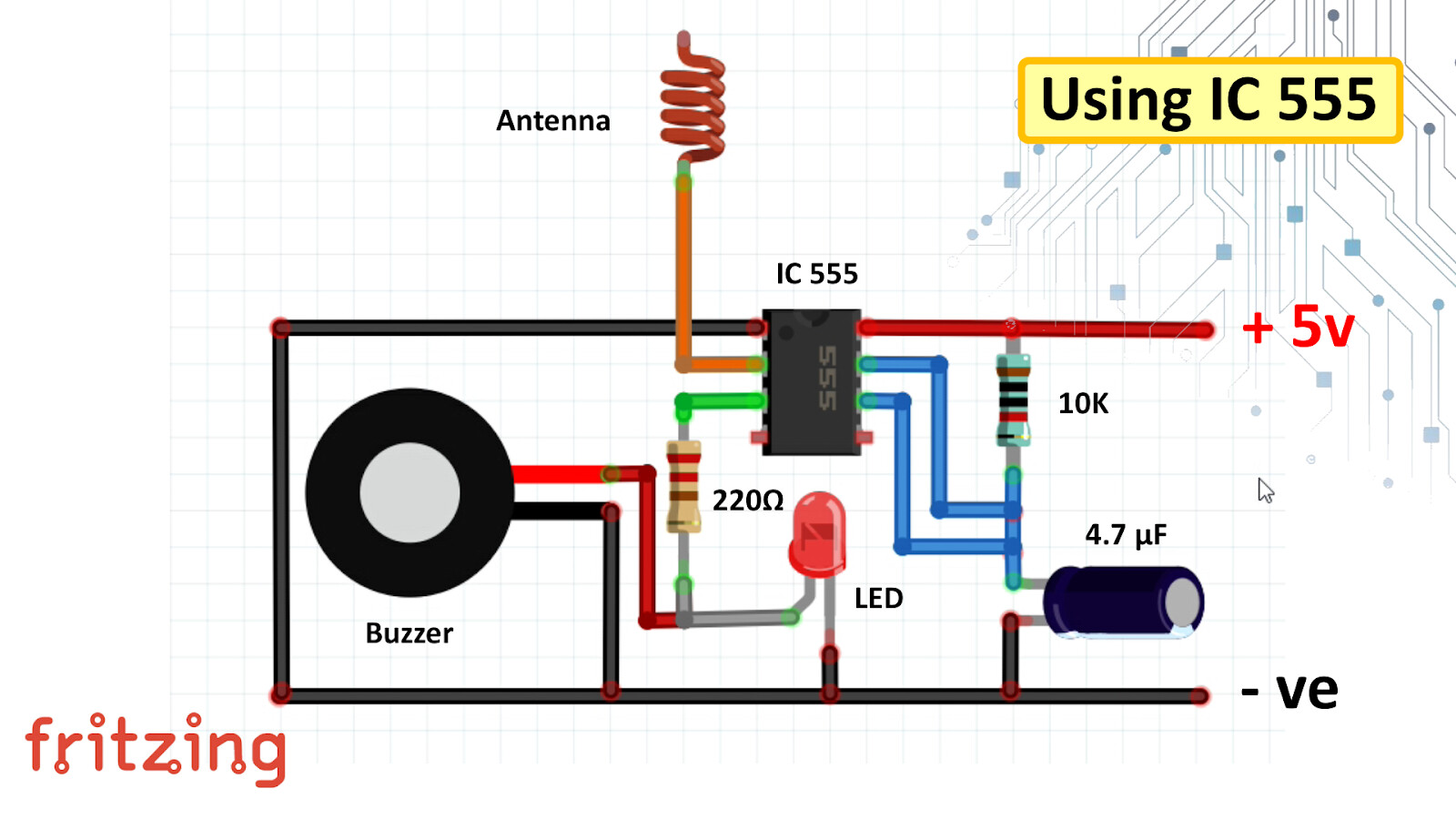

I built a non contact voltage sensor with the 555 timer, it seems to work but how can i adjust the sensitivity of the circuit? seems just a little over sensitive. i just use the led no buzzer
The antenna is on the trigger pin, from what i read trigger must be pulled low to activate trigger. I want to replace the led with arduino Input, How is the cap affecting the circuit? do i need the cap if i dont need the output signal to the led to pulse? wont the signal pulse without the cap since ac +120v then -120v?

I'm kind of liking the idea of this capacitive? 555 timer voltage detector. seems safer, galvanically isolated from the HV source and easy to build. But can i get away without the 4.7 uF cap? i would just send a high/low logic signal from the 555 to the Arduino input pin with a current limiting resistor so i don't care if the output pulses or not. I actually prefer it not to
The 555 timer detects presence of voltage regardless if current is flowing so that nice too.. How can i adjust the sensitivity of the circuit in post 2? Im not sure of the purpose for the 10k resistor
EDIT:I tried using a 900k ohm resistor between trig and antenna but it didn't seem to change anything. My overhead fluorescent lamp triggers it. My antenna is a 28gua 4 inch wire. I think placement of components can have a affect on things BUT there must be a way to change the sensitivity.
