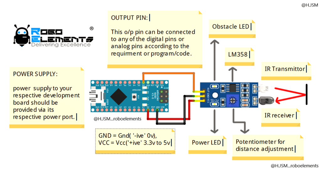

Hey there, I am using an Infrared proximity sensor for my project.
What is the source of your IR energy?
If you disconnect the sensor and gnd the Pin 2, what does your display show?
Do you have a link to data/spec of the IR sensor?
Tom.... :grinning: :+1: :coffee: :australia:

Kindly scroll down to the description section on this website to check the specifications of the IR module.https://www.roboelements.com/product/ir-proximity-infrared-sensor-obstacle-detector/

What is the target that you get the IR sensor to look at?
Is the target hotter than it surroundings.
Tom.. :grinning: :+1: :coffee: :australia:
Unless you can get the response of the IR sensor, you will not know if it is capable of any decent frequency response.
Is the LED on the sensor flashing?
I think you will find it is not designed for your use.
Obstacle detection does not need a high response IR detector.
