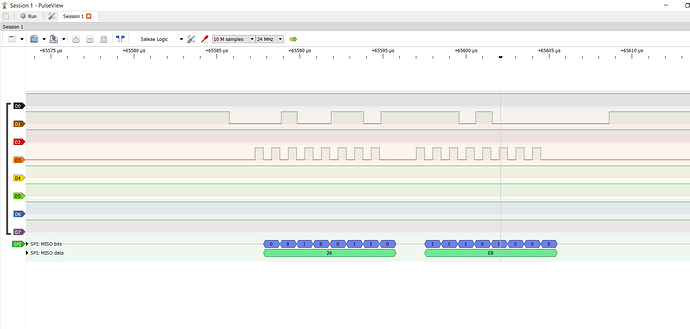

I tried analyzing the signal using an oscilloscope. When probing the MISO and CLK lines, the captured data in the oscilloscope shows the correct hexadecimal value (and is not equal to what the Arduion reads). The code snippet used for reading the data via SPI:

The main issue is not converting/manipulating the 12 data bits but to get the Arduino to read the bits "correctly". The result is as if the CLK is not synchronized with the MISO signal (even though the signal analyzer/oscilloscope shows that it is). E.g. here is a picture when probing the signals:
Where as the Arduino SPI read function returns a way different value (in the case in the picture I got 0x4DD0). I tested reading the SPI data by rewriting and implementing the code you wrote instead, but the issue persists. I've also tried using the SPI.transfer16() method.
I'm currently using digital pin 31, 33 for the ADC chipselects if that is of any interest. The other SPI devices are connected to 23, 25, 27, 29. The SPI MISO, CLK, MOSI, GND signals are connected to the ISCP SPI header. I also just tested my code on another setup using identical hardware, and faced the same issues (oscilloscope shows correct value, Arduino does not). To add to this, a friend of mine helped me test the ADS 7042 using Matlab with the Arduino. The Matlab application was able to read the ADC value using the same SPI settings as I am (8MHz, clock polarity = 0, clock phase = 1).
I think my next attempt to solve this will be to test another SPI library and see if anything changes.
0x26E8 x2 = 0x4DD0

Apologies for the late reply. I've made some progress (and am also feeling very stupid right now). After seeing your question regarding which SPI_MODE I'm using, I re-read the datasheet yet again and realized that I should probably sample on the positive clock edge since the data is output on the negative edge. I should not have been neglecting this just because my friend managed to use SPI_MODE1 without any issues (and sherzaad even pointed this out, I was however only focusing on the SPI.transfer-part).
