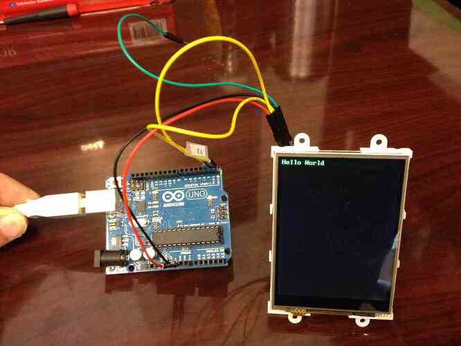

I bought the uLCD-32PTU (https://www.sparkfun.com/products/11677?) and it worked fine using it as a slave with Aduino uno R3 and mega 2560, but I have problems with the Arduino due. I explain: I first loaded the Serial Library for the Picaso (GitHub - 4dsystems/Picaso-Serial-Arduino-Library: Arduino Library for 4D Systems Serial Environement for Picaso) to Aduino's library folder then loaded this code to an arduino uno:

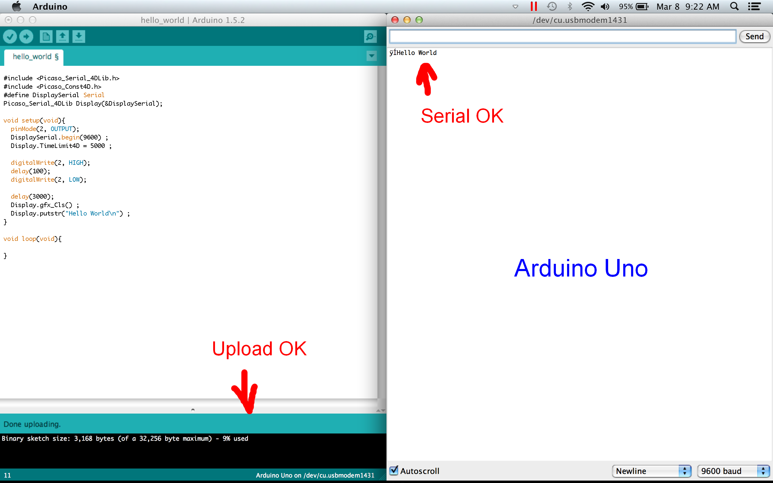

Then connected power, ground RX and TX to the arduino uno, it worked fine (see pictures 1 and 2).
Then I connected and Arduino mega uploaded the same code and it worked fine.

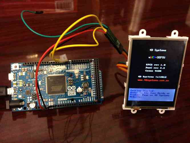

Then I connected an Arduino due uploaded the same code, but there is problem, there are no serial communication on the Serial port and no display on the LCD screen. I am wondering if there is a problem bettween the Serial library for the Picaso and the Arduino due... (I hope I did not make a stupid mistake, pictures 3 and 4 might help).

Solution found!
I showed the library to a friend and he found that a flush in the library was the problem... He says that it is a problem with the due's driver. (it's his opinion, I am not an expert)
Anyway, here is the solution: remove the flush in the Picaso_Serial_4DLib.cpp like this and it will work.
Picaso_Serial_4DLib::Picaso_Serial_4DLib(Stream * virtualPort) {
        _virtualPort = virtualPort;
	//_virtualPort->flush();       // PROBLEM WITH ARDUINO DUE modified by Francois 3/8/2013
