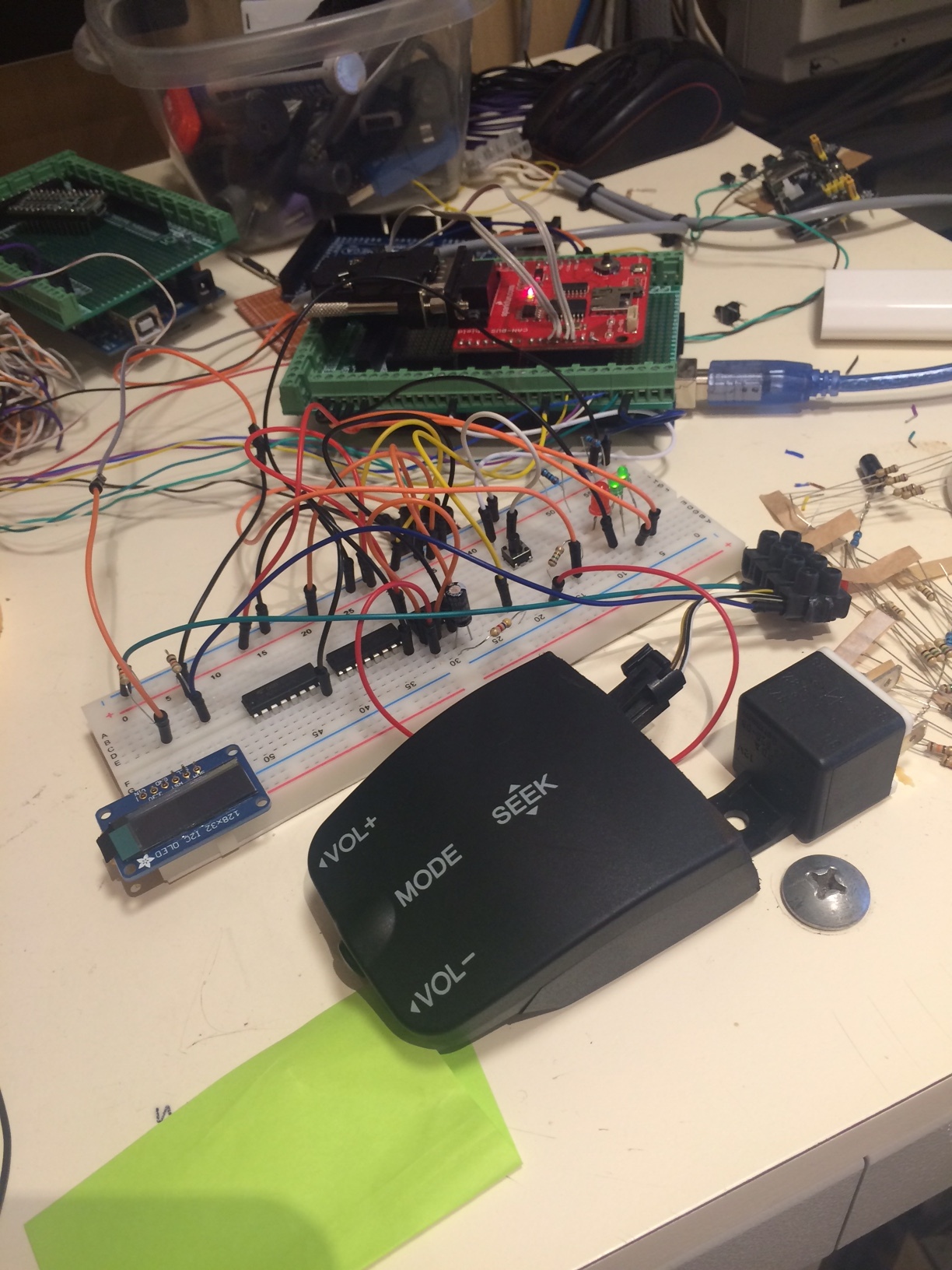

Im using two Ford Focus stereo remotes which I will fit to the binnacle. I´m using a couple of ULN chips and an LM358 to drive the tacho and speedo needles.
Here is the latest sketch - still not complete and a work in progress.
SPEEDO_CAN_BUS_2016_all_outputs.ino (56 KB)
Here are the Ford Controls I'm using. To debounce the analogue input I read the state of the buttons at the beginning and end of the sketch and if they are the same then the switch input is valid. I don't know if that's the right way of doing it but seems to work in practice.
