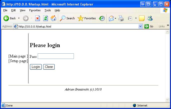

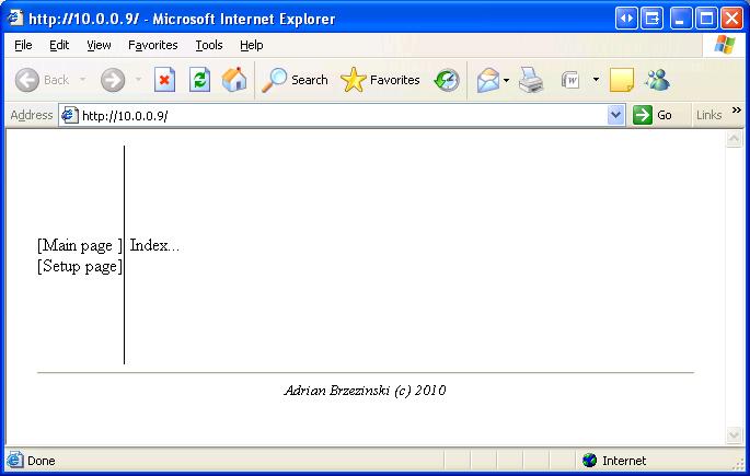

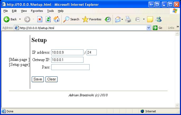

Let me introduce yet another simple TCP/IP implementation. It cooperate with enc28j60 Ethernet chip. Attached example with simple www server implementation takes 6930 bytes for code and 224 bytes for ram.
At this moment it's not validating received packets checksum, but i think we can live without it ;]
Please edit beginning of make.bat file in order to compile it ;]

Hello, i make some upgrades for the previously released code:
  • validating received packets checksum (it's done on the enc28j60 chip so it can handle large packets too)
  • write function can assembly one big packet from smaller chunks
  • buffer (1536bytes) for TCP/UDP data directly on enc28j60 chip. Thanks to this we can use "available" and "flush".
I think compatibility with Arduino Ethernet library is now within your reach :wink:
It comes along with much more advanced example:
You can download example code from here:
