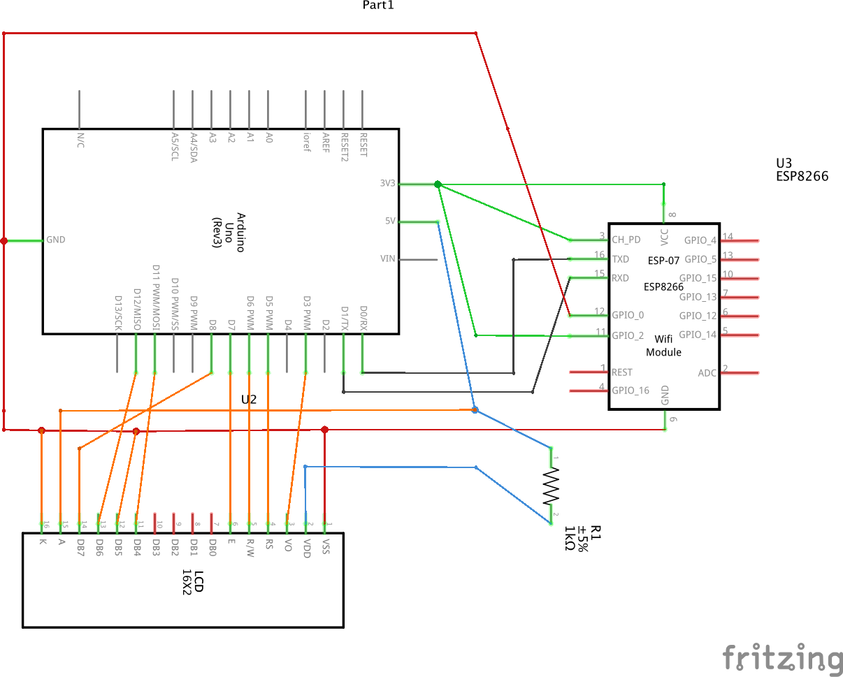

Without a schematic of your connections and the code that you are having trouble with, it is difficult to offer a solution.
I've uploaded the shematic and this is how i initialise the resources in code :

I assume that the posted code is uploaded to the Uno? The wiring of the LCD in the schematic does not match the constructor in the code.
Serial.println("Starting");
That is being sent to the ESP?
And I am concerned that there is no level shifter in the Uno TX to ESP RX line.
I changed the constructor (my bad), but still doing the same.

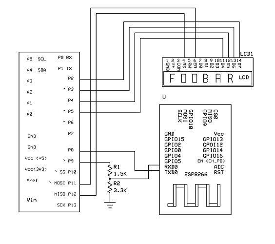

Here is a test sketch for an ESP8266 and Uno to illustrate software serial between the 2 and display the data sent by the ESP to the Uno on a LCD. Tested and prints the data from ESP to LCD connected to Uno. Not perfect but should work for testing the hardware and as a basis for future code. NOTE: change the LCD constructor and software serial pins as necessary.
The Uno code.
#include <LiquidCrystal.h>
#include <SoftwareSerial.h>
SoftwareSerial esp(8, 9);

The circuit:
![ESP-UNO TEST.jpg|1500x1328](upload://3ftX4DFS6hOi0VtPb8m3GS6jybs.jpeg)
Tell me if i what i think is right.
So i take the esp code, i upload it while the esp is on, after that i disconnect the esp, i upload the code of the display on the arduino, then i connect the esp back ?
That is how I did it and that's what you will need to do unless you set up a software serial port on the ESP to talk to the Uno and upload via Serial. But does the ESP8266-01 have enough pins? I have an FTDI connected to the ESP. Vcc, ground, RX and TX of the FTDi to the ESP. Upload the code to the ESP. Disconnect the FTDI TX and RX. Use just the FTDI Vcc and ground to power the ESP. Connect the Uno software serial RX and TX to the TX and RX of the ESP with Uno TX through the voltage divider to ESP RX.
