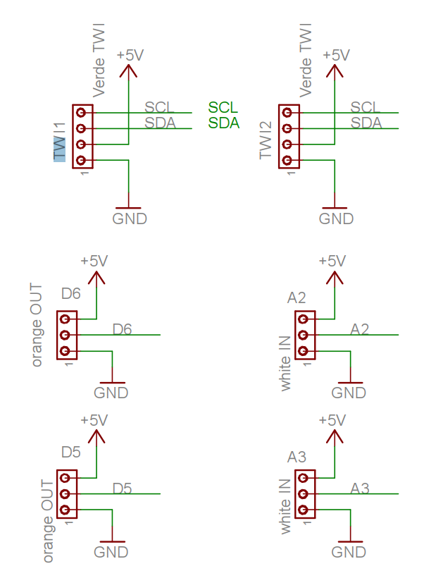

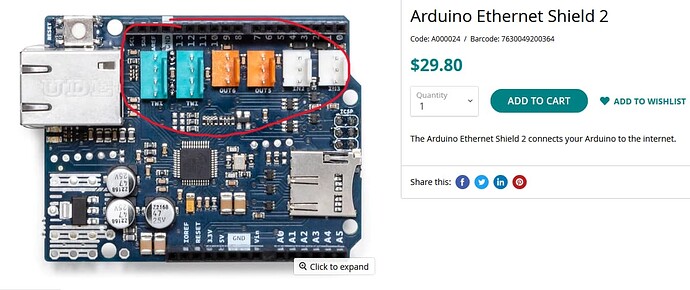

What do these headers on the Arduino Ethernet shield perform?
From https://www.arduino.cc/en/uploads/Main/arduino-Ethernet-Shield2-V2-sch.pdf
Yes, I have the schematic already. But whats the point of them? They are jumpers, quite obviously, but what does selecting different things do?
They are not jumpers, they are connectors designed to take a polarised plug
Basically they connect to pins on the Arduino
Oh right. I thought they had to be jumpers. But why have them? What do they connect to (apart from the Arduino)? Or do they connect two Arduinos to the one Ethernet port? Like what is the point of them? How do they get used? Why are they there? Can I snip them off, or remove them completely without bad things happening?
They make it easy to connect to some of the Arduino pins using a polarised plug which makes it difficult to connect them wrongly. The two blue connectors are I2C connections and allow devices to be plugged in securely
They are connectors to Arduino pins. They do not allow 2 Arduinos to share the Ethernet port. You are overthinking this. You might just as well as why the Uno has a row of sockets along each edge

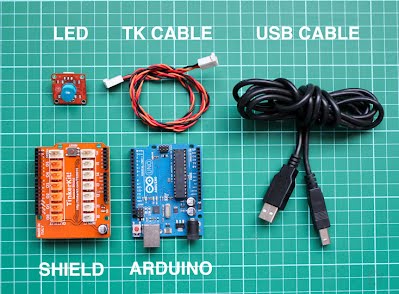

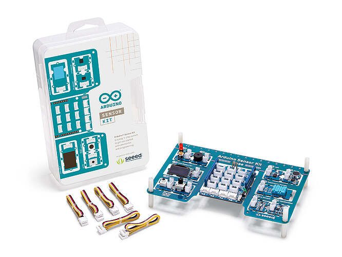

those are TimkerKit system connectors. the TimkerKit project is abandoned. It was developed by Arduino. later Arduino partially adopted the Seeedstudio Grove system
