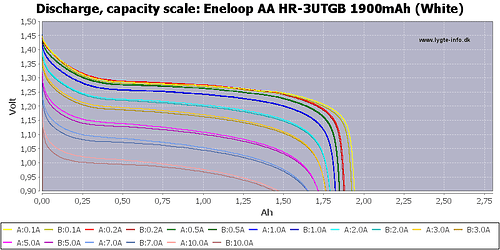

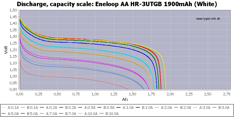

You mentioned 2xAA (3V). Just be aware that if you power your circuit directly from batteries you should account for the battery voltage drop.
For example, an Alkaline battery known to be 1.5V, but actually it's more likely a 1.6V on it's first day and the voltage will drop down to 0.8V when it's fully discharged:
Datasheet from an Energizer AA: http://data.energizer.com/PDFs/E91.pdf
In other words, if you plan to use most of the battery, 2 AA cells in series will be equal to 1.6V by the end of their life... which probably won't be enough to run your circuit properly.
Another option is to use NiMH and NI-Cd rechargeable batteries, which have a lower initial voltage (1.3V-1.2V) but have a more stable voltage while discharging... the only problem is that those rechargeable batteries have very high self-discharge rates, especially on extreme temperatures, making not ideal for projects where you expect to run for more than a few months. The Eneloop seems to be the latest technology for this kind of battery...
An efficient step-up regulator can be the solution for the power supply. It will help keeping the voltage stage along the whole battery life, using all energy available. Just don't go for the cheap stuff and those are delicate circuits and a poor quality capacitor or inductor will compromise the efficiency.
