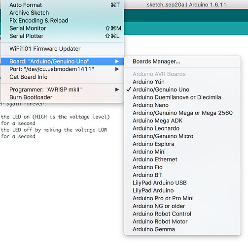

Hello, I don't see the Flora as an option as seen in my screenshot. As you can see, I am running the latest build. Any idea what's up?

Here's a screenshot from their guide which shows the Flora as a board option, but I just dont see it in my options: https://cdn-learn.adafruit.com/assets/assets/000/002/540/large1024/flora_Screen_Shot_2012-11-08_at_12.47.41_PM.png?1396784161
When I try to upload to the board, I get this error: "avrdude: stk500_recv(): programmer is not responding" Screenshot of that also attached.

Did you go to the board manager and download the adafruit boards?
video here
Once installed with the flora selected, you may need to select the port to use.
