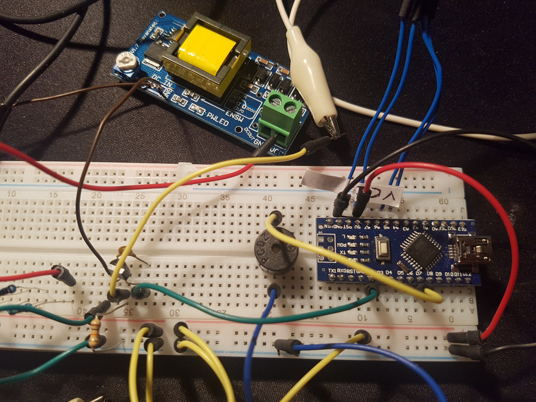

I'm trying to do this project.
I bought everything i need, but in the moment i connected all the components on my breadboard, the arduino counter wont increase.
I don't have an oscilloscope in my home, it's been years, now, that I no longer deal with electronics.
If i measure the sbm-20 with my multimeter the counter start increase.
So i think the problem is not the circuit itself but the tube, or the resistance that i have on the anod of the tube (10Mohm), that drop the voltage to 250V instead of 400V.
i tried to connect the D2 to GND and the counter increase.
I tried to change the 10Mohm resistance to 4.7Mohm, with 27Kohm resistance on the transistor, but the counter won't increase.
I tried to change the transistor, but the counter won't increase.
I added to the code the Serial.println(bt); to see if the counter increase when i use the multimeter, and it does.
I don't know what to do, and i spent money to do this project, i won't leave it. Can you guys help me?

What transistor are you using and have you checked the pinouts and all the breadboard connections?
What are you using to trigger the Geiger tube?
Tom...... :slight_smile:
the transistor is the 2N3904.
when I take the tube out from the circuit, if i connect the terminals, the counter increase.
i checked the pinouts lot of times, they are correct.
the tube let the current flow when ionizing radiation hit the tube.
this event trigger the transistor, that makes the d2 pin going to ground, and increase the counter.

... or the resistance that i have on the anod of the tube (10Mohm), that drop the voltage to 250V instead of 400V.
I suppose you know that if you measure a voltage through a 10Megohm resistor with a DMM with a 10Megohm internal resistance, that you only see half the voltage on your DMM (1:1 voltage divider).
Leo..
I'm using a dmm with 10mohm impedence, so the measurement that i see isnt true?
I'm expecting some kind of voltage drop on the 10mohm resistor...
The tube works with 380v-420v and i see only 250V out from resistor series..
The DMM is a 10Megohm load on the circuit.
That is normally not a problem, but you have to calculate that in if you measure high impedance circuits.
Try measuring a 9volt battery normally and through a 10Megohm resistor, and see what voltage you get.
Leo..

I think i've "solved" the problem, is not the best way but it works.
I connected the tube to this schematic
Then i've connected the pin3 of the ne555 to the D2 of arduino.
Setting the D2 to low, the counter start increasing, and if i disconnect the tube it will stop.
Thanks for the help.
