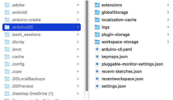

Did you do anything with the hidden folder .arduinoIDE ?

I have not done anything with the hidden folder. And I don't see it in library>application support or the Applications filer Where is it located?

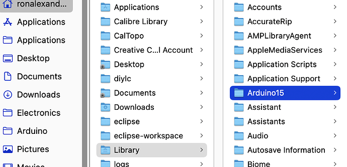

To totally remove the Arduino IDE delete the following folders then just download the correct (X86 or Mac Silicone).
To see the hidden files use the 3 key combo inside the [] [Shift Command .]
Open finder and click your name, you should see the following. Since you didn't install the agent, the first folder .arduino-create is probably not there. The second folder is the Arduino15 which is under your Library folder under your username, see 2nd pic. That gets rid of all the Arduino files except your sketches and any libraries you have in your sketchbook, they are ok. I included a screen grab of the downloads, you want the last one Apple Silicon.
