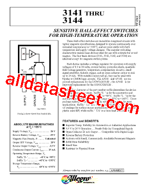

Hi, i want to make a speed tachometer for my bike with a hall effect sensor
For testing im using a arduino uno and a 16x2 lcd with i2c.
When i connect the hall effect sensors output to the arduino, the closer i get to the bike while its idling the more it "interferes" with it, (it reads 40kmh when the bike is standing still).
The cable that leads to the hall effect sensor is coated with copper tape and grounded.
is there something i can do to stop this form happening, diode? capacitor?

ok thx :slight_smile: i measured the hall effect sensor directly with a oscilloscope, when i get near the spark plugs i get a little spike of voltage, 800mv or so. is this enough to trigger the interrupt? And how much voltage does it take to trigger a interrupt when its set to trigger on "high"?

hi, thanks for the explanation :slight_smile: yeah i realized they are a mess when it comes to interference :frowning: iv measured the length of the voltage spike, and it is 40ns and the voltage is enough to trigger the interrupt. Is there a way to make arduino not count it if the pulse is smaller than lets say 50ns? If someone could make an example code i would appreciate it :slight_smile:

Thx for your answers :slight_smile: but i finally figured it out! Instead of sorting the problem with the arduino i managed to sort it out with the bike. It turns out that this has been a common problem with older bikes/cars (older than mine). so they added resistors in the spark cap and/or in the spark plugs and spark plug wires. Mine has it in the spark caps and plugs (5kohm each), these tend to wear out and mine was totaly gone + previous owner(s) changed the spark plugs and decided to not use resistor plugs. I replace both parts and now it works like a charm!
