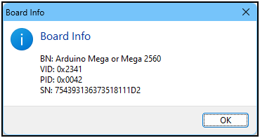

Populate "Board Info" dialog from port data (#1489)
arduino/arduino-ide#1803, arduino/arduino-ide#1489
The dialog accessed via the Tools > Get Board Info menu showed information from the definition of the currently selected board. This information was not very useful. The information shown in the dialog is now read from the hardware attached to the currently selected port, consistent with the behavior of Arduino IDE 1.x:
