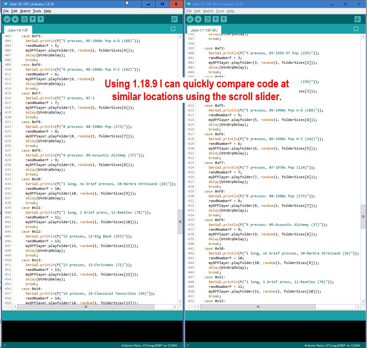

  2. The scroll bar slider thing now fades out after use! Can't begin to understand that change. Locating it is not only slower, but I cannot now line up two sketches and use the slider to quickly match up code when debugging.

As a quick and dirty workaround for the lack of separate Serial monitor window just open a second instance of the IDE that is attached to the same COM port as the one with the sketch in
Are you sure that the scroll bar fades out after use ? Both vertical and horizontal scroll bars disappear when the mouse pointer is moved out of the IDE window which is bizarre
You’re right, it’s the whole scroll bar that goes AWOL. And why is it so narrow? I have the IDE window at the right of my screen and the scroll bar is now hard to see and click on even when it’s displayed.

"...Locating it is not only slower, but I cannot now line up two sketches and use the slider to quickly match up code when debugging."
It can be done in 2.0 but not as easily and quickly.
BTW, why does the slider need to be (slowly) faded in and out anyway?

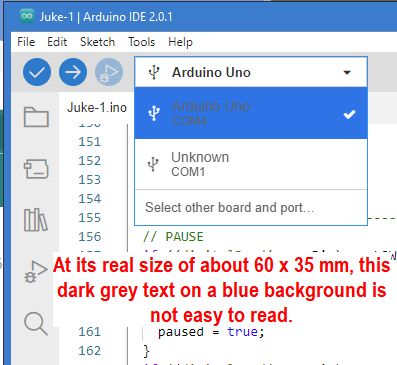

As we're covering several points here, just one cosmetic:
ColourChoice

The decision was made by project management that the "Light (Theia)" theme you are using will be removed from the Arduino IDE:
Until that time, no further development resources will be allocated to fixing bugs with these themes. So the only way this would be fixed is via a 3rd party or custom theme.
The workaround is to use one of the supported themes ("Light (Arduino)" if you prefer a light theme). The contrast is pretty good in those themes. If you spot any problems when using one of the supported themes please do let us know.
Well, IMO it’s being used whenever I’m looking at the screen - to see at a glance where I am in a long sketch!
And could its tiny area realistically be used for anything else?
