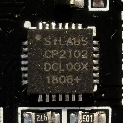

Please tell us which USB to serial bridge chip your Arduino board has. This is a black chip near the USB socket.
The chip will usually be identified by writing on the top. This might say something like "WCH CH340G" or "SILABS CP2102".

The USB to serial is CP2102
I managed to solve the issue by deleting and reinstalling the CP210x driver from the device manager
