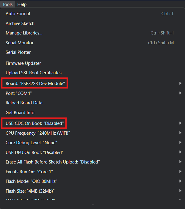

Hello,
i am encountring a problem with the serial.
I apploaded a simple code to the ESP32S Dev Kit:
#include "Arduino.h"
  while(!Serial);
  pinMode(1, OUTPUT);
  Serial.println("Serial is working");
  Serial.println("New Line is written!");
  digitalWrite(1, HIGH);
  delay(2500);
  digitalWrite(1, LOW);
  delay(2500);
Pin 1 is being written HIGH and LOW.
The problem is that i am not getting any output on the serial.
What can be the reason?
Your link shows a ESP32-S3. If you selected that (or similar) in the IDE, you will have the option to enable USB CDC on boot; give that a try.
This option however is not available for every ESP32 based board (e.g. for the DOIT ESP32 DEVKIT V1).

Thank you for the reply.
I have tried with out the PIN 1, no response.
I will try your suggession and hope it will work.
First check the baud rate on your serial monitor, and then restart the application.
Also try removing the cable and plugging it in.
Try removing while(!Serial);
Does the sketch work with an older esp32 like the DOIT?
Try a delay(1000) after the Serial.begin. I've found that needed on the faster boards to get it working. Don't know why, just is.
Thank you all for the repllies,
the problem was within the settings.
I have changed the settings and now i get out the serial messages.
