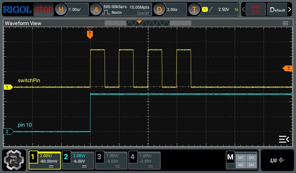

This is how the sketch performs:
note that the 'switch' input comes from a function generator and may not be representative of bloko's switch.
