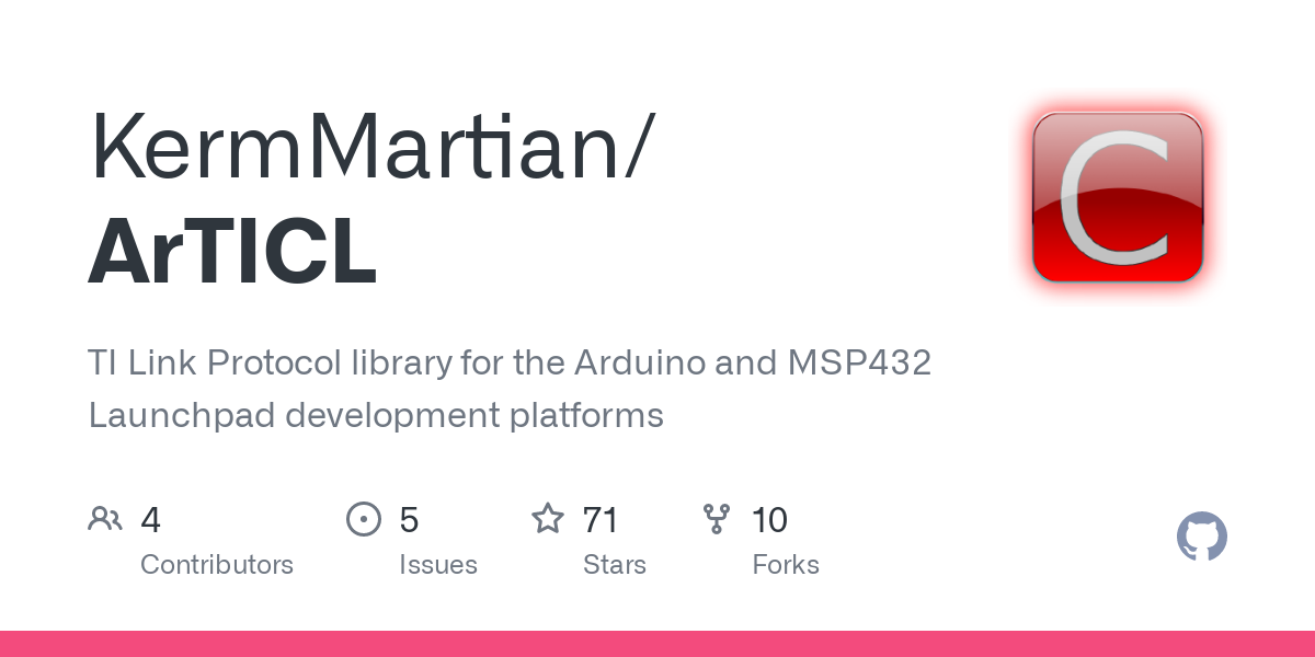

I came across this library, and it seems to have pretty good tutorials. I don't want to use this because it utilizes another shield unless it's impossible to progress in the project. I want to use just the Arduino and nrf24l01 so I can shrink it later into a rf nano if the project works out. Correct me if I am wrong. I don't have much experience with the TI Link Protocol.
The TI protocol does not require any "shield", just two I/O pins, two resistors and some code.
Huh. The guy in the tutorial was using some shield. What was that used for?
Maybe the guy was just lazy and used whatever was handy. I'll bet that if you studied the tutorial, you could figure something out! You do need to use 3.3V logic levels.
Alright so does this replicate what @zwieblum was saying about the ti protocol?
I might guess that, judging from the library title.
@zwieblum recommended to read the documentation. Did you do that?
Yes I just wanted to make sure.
I used the articl library, and it seems to work for sending characters from Arduino to calculator. Can someone help me with the code aspect for sending a message from calculator to an Arduino serial monitor? I really bad at coding and don't have much experience with TI calculators.
